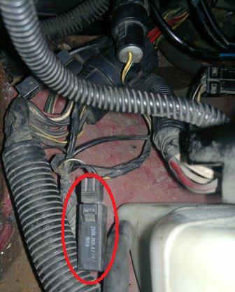

  2. I thought I would update this. My car started and I was able to adjust the timing and take it for a spin around the block. I can't say I did anything or replaced anything, it just decided to start one afternoon. A few days later I tried to start it up to drive to work and it wouldn't. I turned, but there was no combustion. I left it until the weekend. After a bit of tesing on the fuel injector and ECM connector (the 10 pin conn), it started up, but when I attempted to take it for a drive it stuttered and stalled out in front of my neighbors house. I pushed it back to my place, thankfully it is not heavy and there was a downhill section. I tinkered with the fuel injector connector and it started up. I let it warm up fully and put it into test mode and drove around my neighborhood, but it stalled and died while driving. I tinkered again with the fuel inj conn and it started and got it home. So I am not saying it is the connector, that could be coincidence. I get continuity from the connector at the ECM to the fuel injector, and the fuel injector tests okay for resistance. This seems like an intermittent short. I don't know what I need to do to fix this to keep it from stalling out. Around the neighborhood is somewhat okay, but I work 20 miles away from home, and I don't want this breaking down on the I-90 bridges.
