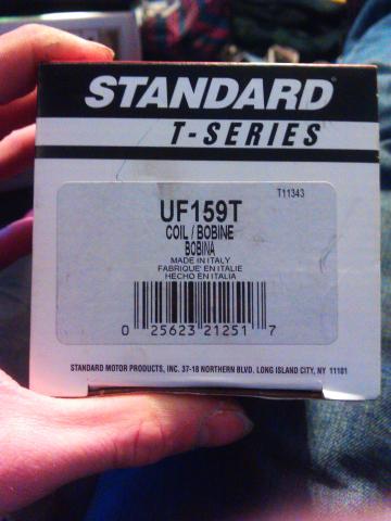

amill replied to amill's topic in 1990 to Present Legacy, Impreza, Outback, Forester, Baja, WRX&WrxSTI, SVXi still have the reciept and my old coil i can see tomaro if i can get a refund but he'll prob charge me a restocking fee since i already put it on the car.
wrong plugs wires and coil pack??? maybe??
amill replied to amill's topic in 1990 to Present Legacy, Impreza, Outback, Forester, Baja, WRX&WrxSTI, SVXso that 100$ standard t-series is crap? and i just wasted that money? and should i get NGK Nickel Spark Plug they r 2.39 each at andvance autozone its closest place to me.
amill replied to amill's topic in 1990 to Present Legacy, Impreza, Outback, Forester, Baja, WRX&WrxSTI, SVXdo you have any wires for sale? im going to go get the ngk plugs tomaro but wat about the coil is thnat one ok. the one that was sparking was a diamond.. this new one was 100$ and i guess since i get payed 8/hr atm 40$ doesnt seam cheap to me lol.

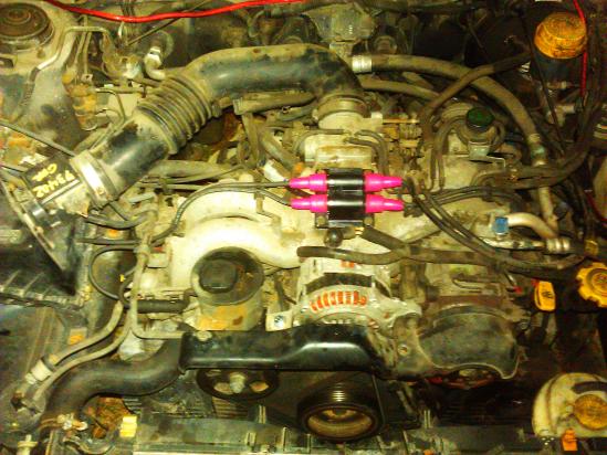

amill replied to amill's topic in 1990 to Present Legacy, Impreza, Outback, Forester, Baja, WRX&WrxSTI, SVXim not 100% sure of the plugs that i got since i did them when i first got the car but i just bought this coil cause this morning it was shooting a spark out of one of the female in ports. the wires are 7mm sillicone suppression cable SAE class e autolite pro series premium
first thing i did when i bought this car was a typical tune up but i had no idea there were certain plugs and wires and coil pack for subarus. all i did was go to autozone and told him my modle car and year. plz if you let me know what is the best plugs wires and coil pack for 1995 subaru legacy l 2.2 fwd id rlly appreciate it ive searched forums and google. i just dont want the plugs to blow up or something.

amill replied to amill's topic in 1990 to Present Legacy, Impreza, Outback, Forester, Baja, WRX&WrxSTI, SVXReplaced the coil pack today. this morning when i was letting my car warm up before work i noticed it was idling very weirdly. i looked under the hood and sure enough sparks were jumping out of one of the wire plug ins on the pack. sigh now waiting on the knock sensor hopefully thatll fix the rest, sigh : /
