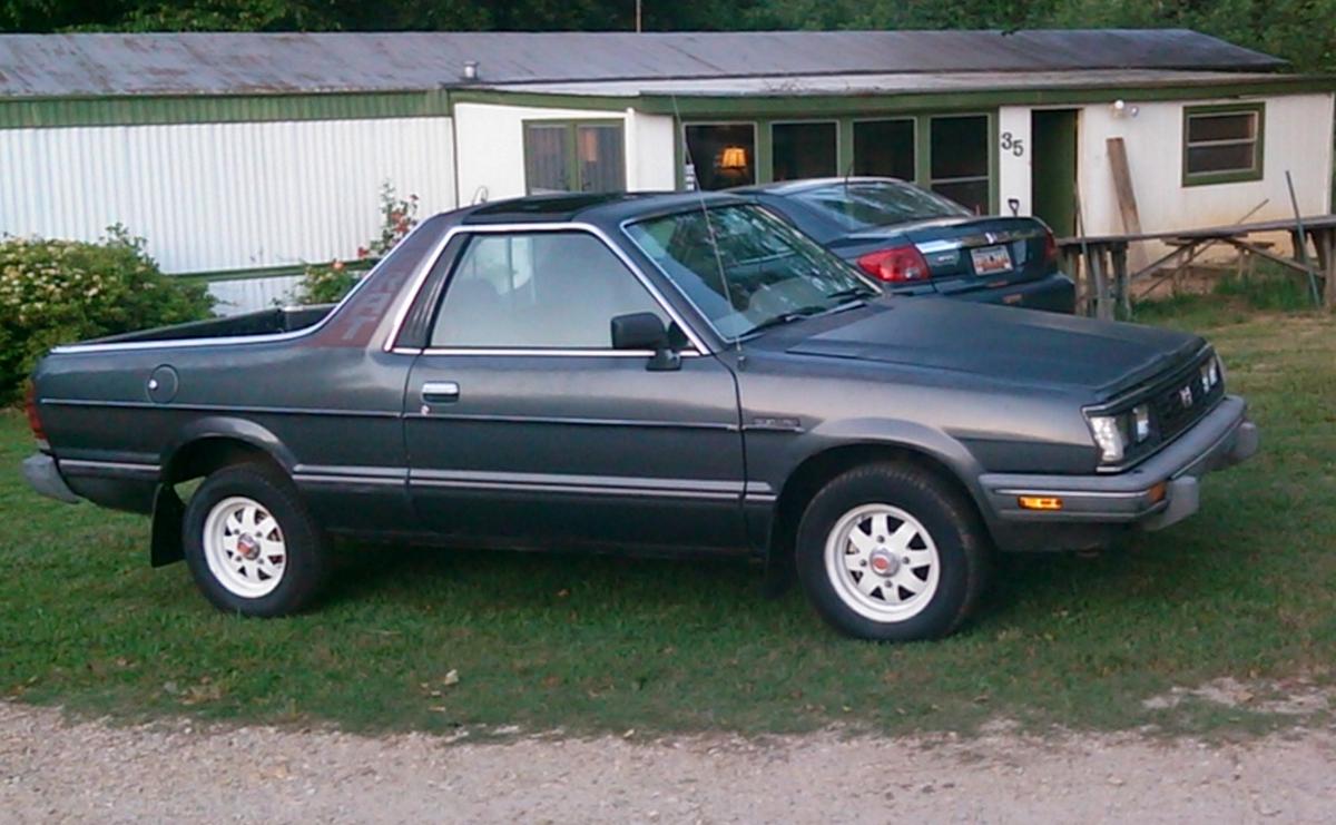

  1. This is one of my Brats up for sale on Ebay.. http://www.ebay.com/itm/1986-Subaru-Other-GL-/322542983755?hash=item4b190f5a4b:g:RyQAAOSwlY1ZNJaF&vxp=mtr
