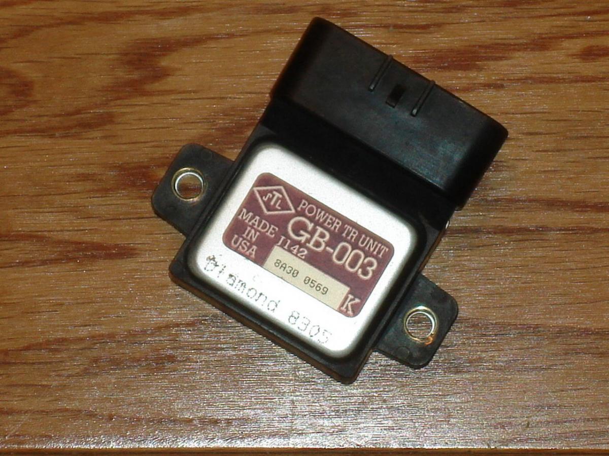

  1. I wont to replace the Coil igniter and coil pack on my 1997 Legacy Outback 2.5L automatic. I can not find the location of the Ignitor/starting module . Have not been able to find any info online either can one of you folks tell me were its location is on my vehicle?
  2. 70mph on the freeway when the engine started to missfire, exited and drove at 35 mph 2 miles home. motor starts and idles,when i put the code reader on i got PO301 and PO302. what would cause a missfire like that? faulty coil pack, something going to ground?

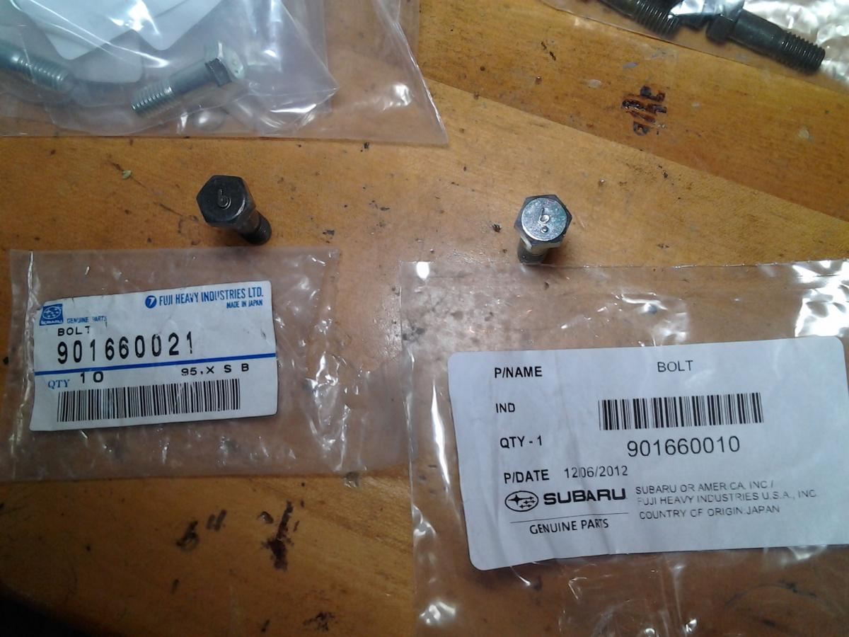

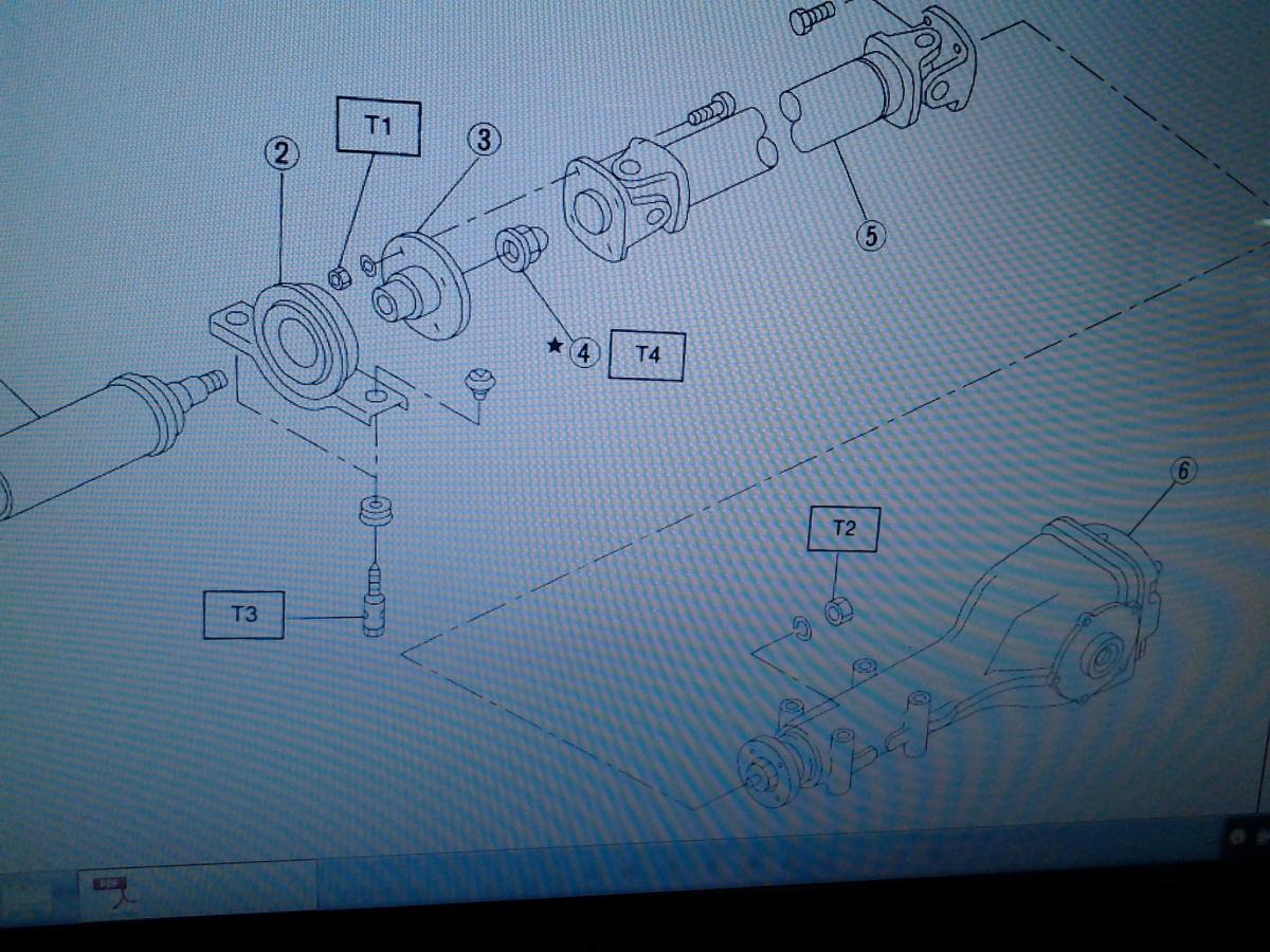

  4. Got the Transmission in and it works great,I have received the bolts from the dealer to install the drive shaft section from the center bearing back,I did not remove the bolts and am not sure witch bolt goes were? There are 2 sets of 4 bolts,the set of darker bolts has a #6 on the head. The polished bolts have a #6 with a dot. My question is were do the set of dark bolts with #6 go,Center carrier or rear diff flange? Thanks for your time.

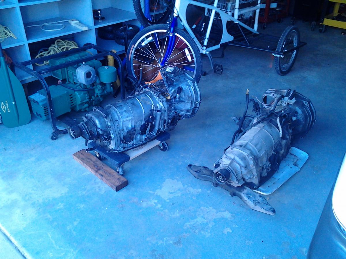

  6. Being installed in a 1997 Legacy Outback 2.5L.The numbers match TZ102Z2CBA-DT,there are a few items to swap like the cross member and a piece of wiring section. I have installed a few auto trans and am aware of the issues involved with the torque converter. the donor trans has 200K miles,my car about the same,my concern is should i remove the pan and install new filters?
  7. I took the damaged trans out a few months ago and just picked one up for $506.00 delivered. We unloaded it and it looks fine,now i'm going to swap parts over and get ready to install. What steps should i take before installing?
