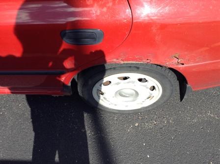

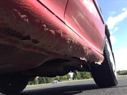

  5. Hello All, I am brand new to this world of Subaru. I have started my experience by purchasing a 1998 Impreza L with the 2.2L (that is the EJ22 correct?). Having 125000 miles on it, the rust has taken over the rockers as well as the rear wheel wells and fenders. I am looking for some rust repair panels online and have come up with nothing. THE QUESTION: Has anyone had any experiences with repairing the rocker panels / wheel areas from the rust cancer? Were you able to find any pre-made rust repair panels? Kind Regards, Mikey
