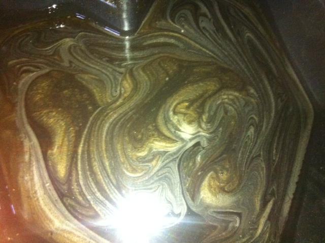

Trying to decide whether the transmission is bad-picture of oil
murfmv replied to murfmv's topic in 1990 to Present Legacy, Impreza, Outback, Forester, Baja, WRX&WrxSTI, SVXIt looks more like motor oil
murfmv replied to murfmv's topic in 1990 to Present Legacy, Impreza, Outback, Forester, Baja, WRX&WrxSTI, SVXThanks for your comments. Have loosened the CV boots and both indicate plenty of grease without tearing. Should get the axle out today and see if binding disappears. Still worried about the binding and clunking symptoms that caused the initial concern. Also there was oil leakage from the area at the engine transmission junction, possible indicating seal leak caused by increased rotational abnormality possibly caused by transmission wear.
Earlier this week I posted some questions about whether the transmission or just the Front right CV joint is bad. There is definitely a spot where the wheel gets stiff when turning with all wheels off the ground. Haven't disconnected the right CV joint yet but here is a picture of there oil from the transmission. The good news is there no metal pieces found in the oil, but there definitely is fine brass or some metallic wearing going on by the oil condition. What do you think?
