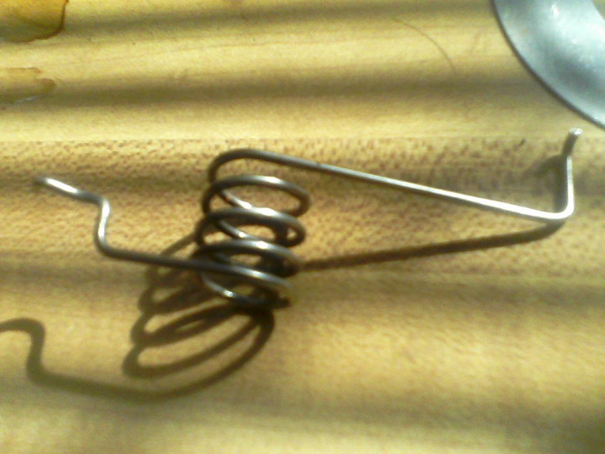

Louinaz replied to Louinaz's topic in 1990 to Present Legacy, Impreza, Outback, Forester, Baja, WRX&WrxSTI, SVXhttp://opposedforces.com/parts/legacy/us_b11/type_26/automatic_transmission/at_transfer_and_extension/illustration_1/ this is the tail shaft I'm dealing with, got it here in front of me, Don't see this spring in the diagram. was fairly confident of this procedure till this spring appeared.

Louinaz replied to Louinaz's topic in 1990 to Present Legacy, Impreza, Outback, Forester, Baja, WRX&WrxSTI, SVXWhen I pulled the tail housing a spring came out I don't know how it's configured when in place since I wasn't aware of it till the tail shaft was out and in my hands. I have a picture of it in my email how do I post the pic to get a little guidance?
