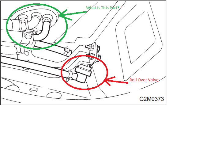

  6. My Subaru 1995 Legacy has a fuel leak. The leak is under the car, right in front of the driver's rear tire. There is an oval part with 3 pipes going through it and 3 hoses connected to it. One of the metal connectors is leaking, and I need to replace it. I cannot seem to figure out what the part is called, it is beside the roll over valve and the fuel delivery hose, return hose and evaporation hose go through this part. Can someone please help me identify this part : Here is a picture of it looking from underneath the car. Thanks Khamier
