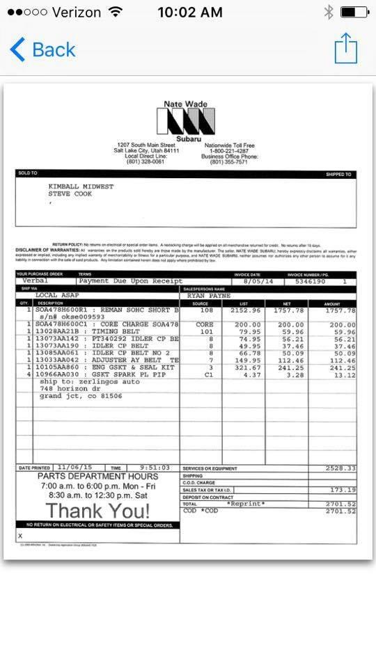

Yotanut replied to Yotanut's topic in 1990 to Present Legacy, Impreza, Outback, Forester, Baja, WRX&WrxSTI, SVXThe 2000 was hit in the back and totaled less than 30 days ago, so not sitting more than 30 days.
2.5 engine comparability
Yotanut replied to Yotanut's topic in 1990 to Present Legacy, Impreza, Outback, Forester, Baja, WRX&WrxSTI, SVXWhat would the cam and crank sprocket have to do with it? The engine in the 2000 is documented 35000 mile factory replacement Subaru engine.
