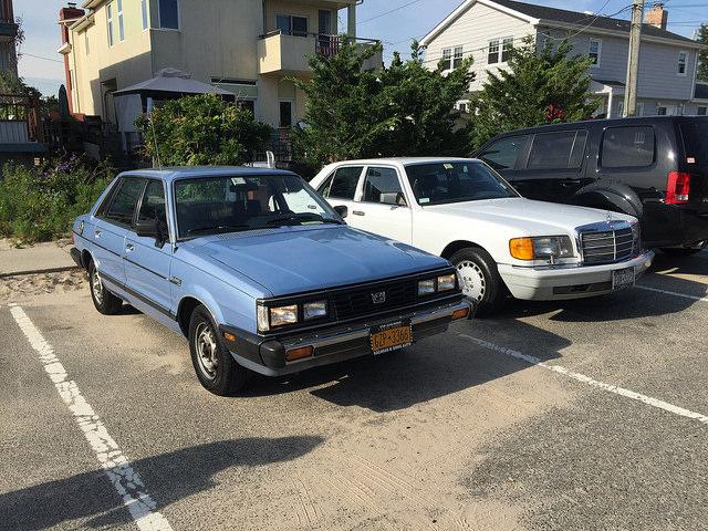

  2. Well I bit the bullet and bought the Weber for $320. Also bought new plugs, wires, cap, and rotor while I'm at it. I should be getting the parts next week and let you all know how the install went. Here's a picture of her in Vermont.

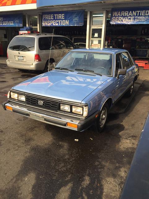

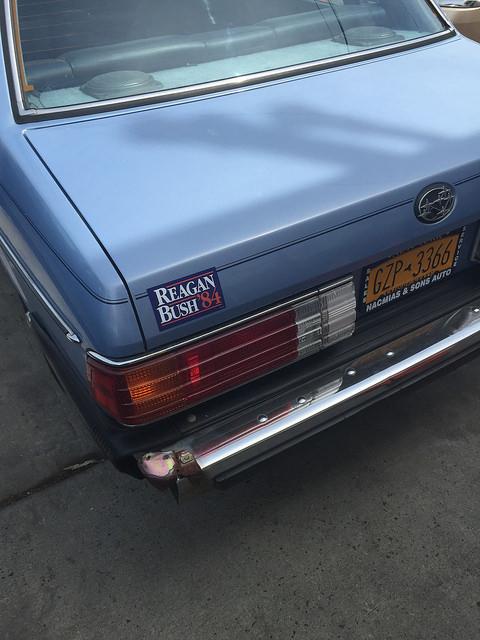

  4. Hi all. I just picked up a 1984 Subaru GL for $250 and by far its the best $250 I have ever spent. I'm having an issue with it and need some help. When I drive with the headlights on, the second cooling fan goes off and causes the car to run hot, especially if I have the A/C on. I am mechanically inclined, but with this I have no idea where to start and before I send it out somewhere I want to see if I can take care of it myself. Also, if anyone has the rubber trim for the left side on the back bumper for sale, I'd like to buy it. Here are a few pictures of it and my 1990 300SE and the bumper trim that is missing. Thanks in advance!
