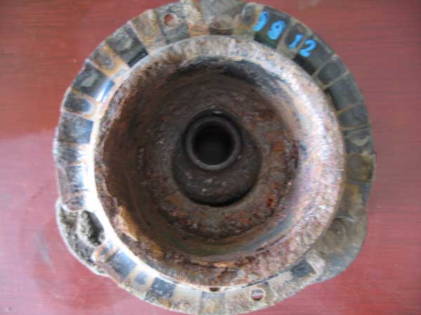

xyzgeoman replied to xyzgeoman's topic in 1990 to Present Legacy, Impreza, Outback, Forester, Baja, WRX&WrxSTI, SVXSo, thanks all for the help. Just thought I'd throw in a picture of what all the clunking was about. The strut mount was definitely broken and all that banging around had really taken its toll. (Notice the strut wasn't even centered in the mount any more.)

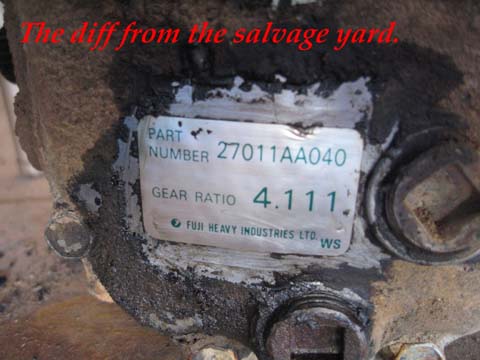

xyzgeoman replied to xyzgeoman's topic in 1990 to Present Legacy, Impreza, Outback, Forester, Baja, WRX&WrxSTI, SVXJury says 4.11! Well, suggests 4.111 here: http://www.ultimatesubaru.org/forum/showthread.php?t=57742 This is confoundingly convoluted: http://www.ultimatesubaru.org/forum/showthread.php?t=52723 And this says non-turbo 90-94 Leg's were 4.111: http://www.ultimatesubaru.org/forum/showthread.php?t=2616 Also, found these for those who want a ton of info: http://surrealmirage.com/subaru/trans_spec.html http://surrealmirage.com/subaru/motor_trans_combo_spec.html And if all else fails, look in the owner's manual!

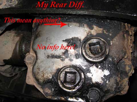

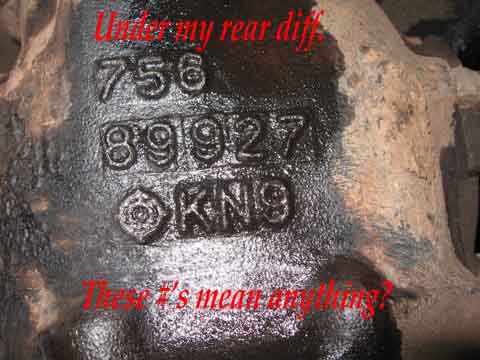

xyzgeoman replied to xyzgeoman's topic in 1990 to Present Legacy, Impreza, Outback, Forester, Baja, WRX&WrxSTI, SVXSo, the diff I got from the salvage yard says it's a 4.111 ratio. I thought my car (90 Legacy L Manual AWD sedan) had a 3.9. Correct? But, from ye olde photo below you can tell that my diff's label is long since gone. What gives? I told the guy at the yard my year, make, and model. He said he had it and I went and picked it up. Today I started the project and got to thinking, "I'd better double check what that label says." So, am I right that this rear diff I just bought is NOT going to work?

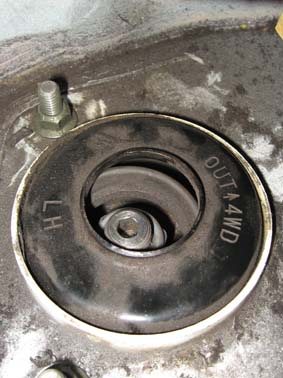

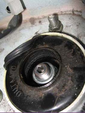

xyzgeoman replied to xyzgeoman's topic in 1990 to Present Legacy, Impreza, Outback, Forester, Baja, WRX&WrxSTI, SVXSo, a new strut is one thing and a "strut top" is another? Just making sure I know what all I'll need to buy. Also, here's a pic of the off-center strut (drivers side) peeking out from the top. And the "good" strut (pasgr side) with a seal or something sticking up out of the mount.

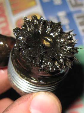

xyzgeoman replied to xyzgeoman's topic in 1990 to Present Legacy, Impreza, Outback, Forester, Baja, WRX&WrxSTI, SVXSo, I need to fear the hum and dread the torque bind? THe current hum does change with wheel speed, but it's not a roar. Also, I know torque bind from my other Subie...no torque bind at this juncture. So, I guess I'll be shopping around for a rear diff to put in so's I'm not stuck somewhere 80 miles out Also, I'll try to attach a photo of the rear diff drain plug (magnetic) when I pulled it last night.
