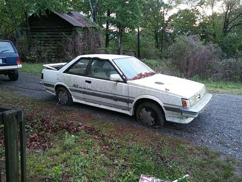

Hiya! My name is Allan. I am the proud owner of a recently purchased (last week) 1987 Subaru RX! It is a woods find, acquired for a very low price, as it needs quite a bit of work. I've done quite a bit of research about my beloved RX and hope to continue to learn more from the highly knowledgable folks here on USMB! I live in Winston Salem NC (Rural hall technically) so anyone nearby especially those with any experience with the late 80s Subaru and EA series motor, would definitely like to get together and learn a few things (ill buy the drinks!) I plan to make some sort of build thread of my Subaru, from its dismal days as the home to a opossum family (mama and 3 babies) to restoring it to its full rally-esque glory! Keep it classy ladies and gents, and may the odds be ever in your favor
