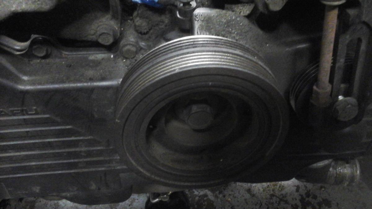

Kmenex replied to Kmenex's topic in 1990 to Present Legacy, Impreza, Outback, Forester, Baja, WRX&WrxSTI, SVXI also have early signs of crank shaft pully wobble, no failures yet but wondering if anyone can suggest anything to correct this... Will check deeper once engine is out and timing is taken off and checked.

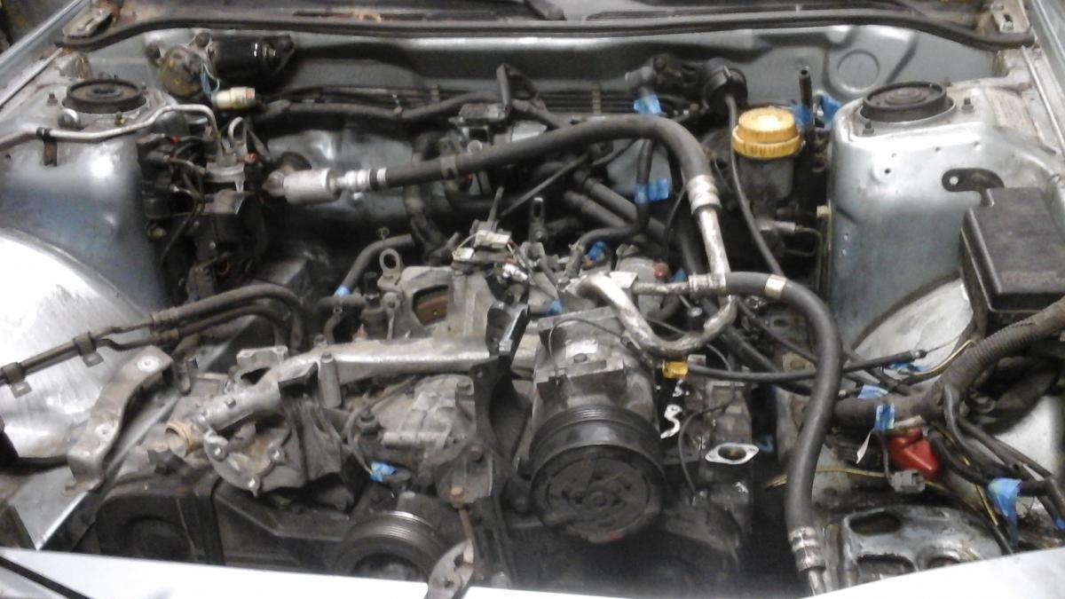

Kmenex replied to Kmenex's topic in 1990 to Present Legacy, Impreza, Outback, Forester, Baja, WRX&WrxSTI, SVXI'm pulling the engine to do head gasket and other maintenance and clean up but I'm stuck here with this AC unit and what to do during engine clearing. Any tips? See attached photos
