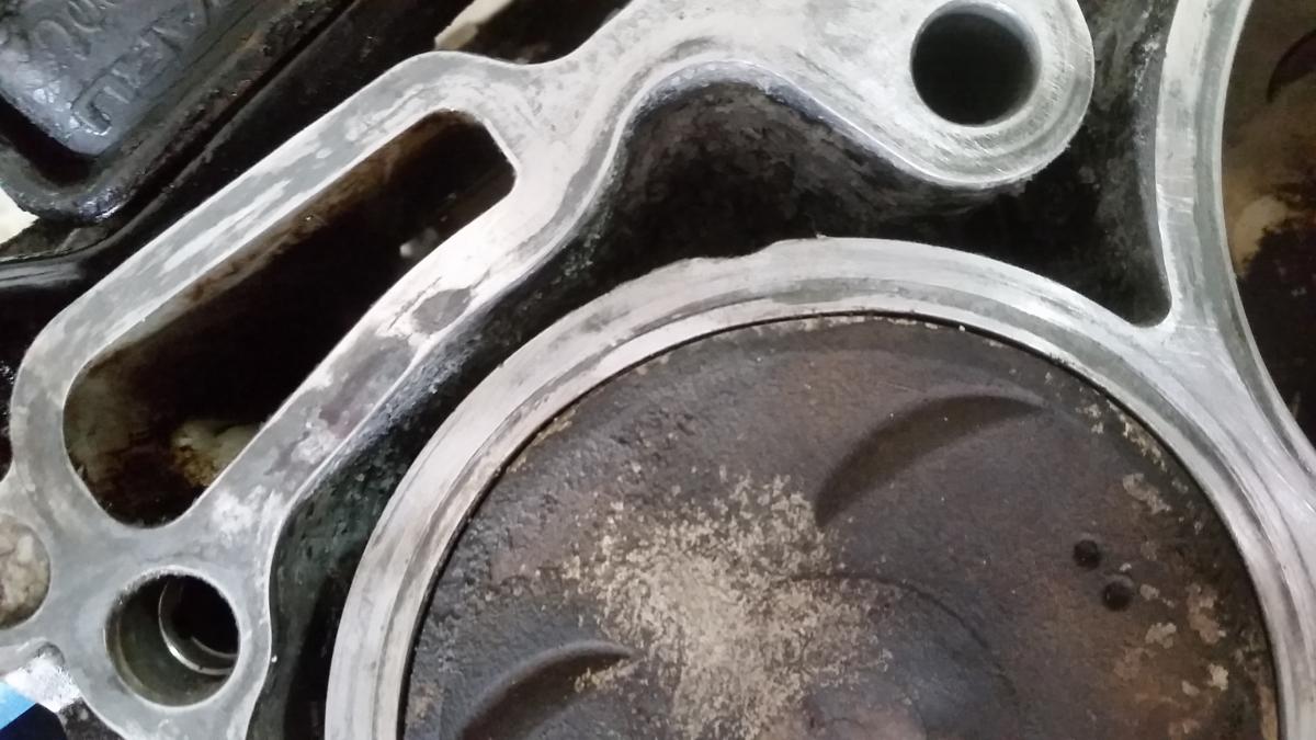

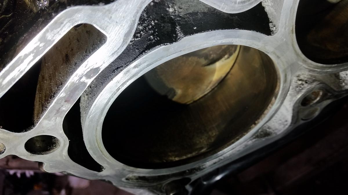

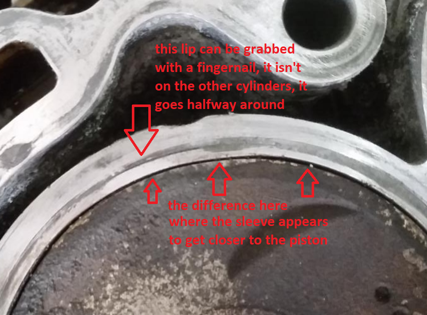

Help! Cylinder sleeve separation?
Dake replied to Dake's topic in 1990 to Present Legacy, Impreza, Outback, Forester, Baja, WRX&WrxSTI, SVXWow, lots of great info! Thanks guys, it feels great to be learning about this. Based on responses in another thread I posted I already suspected ring issues, and now that I have 2 good reasons to dive into the block I suppose it’s the best thing to do. I’m all about fixing it "the wrong way" if I’m the only one depending on it but I don’t plan to keep this car for a long time, and I couldn’t in good faith sell it without doing it right. This is cylinder 4 on an EJ251 with a history of having its coolant passages plugged solid with buildup (heavily at #4) and being driven that way.
Guys, I'm in the middle of reassembling my engine. Was hoping to have it running today but this stopped me in my tracks. There's a lip that you can catch a fingernail on, is that what I think it is?
