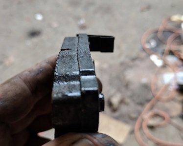

  1. Welp I feel like an idiot haha, but for any future readers I'll share what the problem was: I went to pinch off the front lines per crazyeights recommendation to narrow down between MC and front calipers and noticed the inner pads were sitting at a slight angle relative to the disc, on closer inspection I hadn't fully seated them in the notches, so the pad was sitting on the caliper brackets on the top side meaning the piston was flexing the pad when the brakes were pressed. Pulling the handbrake would pre-flex the pads thereby stiffening up my brakes. Pads took a slight curve from all this flexing so I replaced and everything's good now. Thanks everyone for the help.
