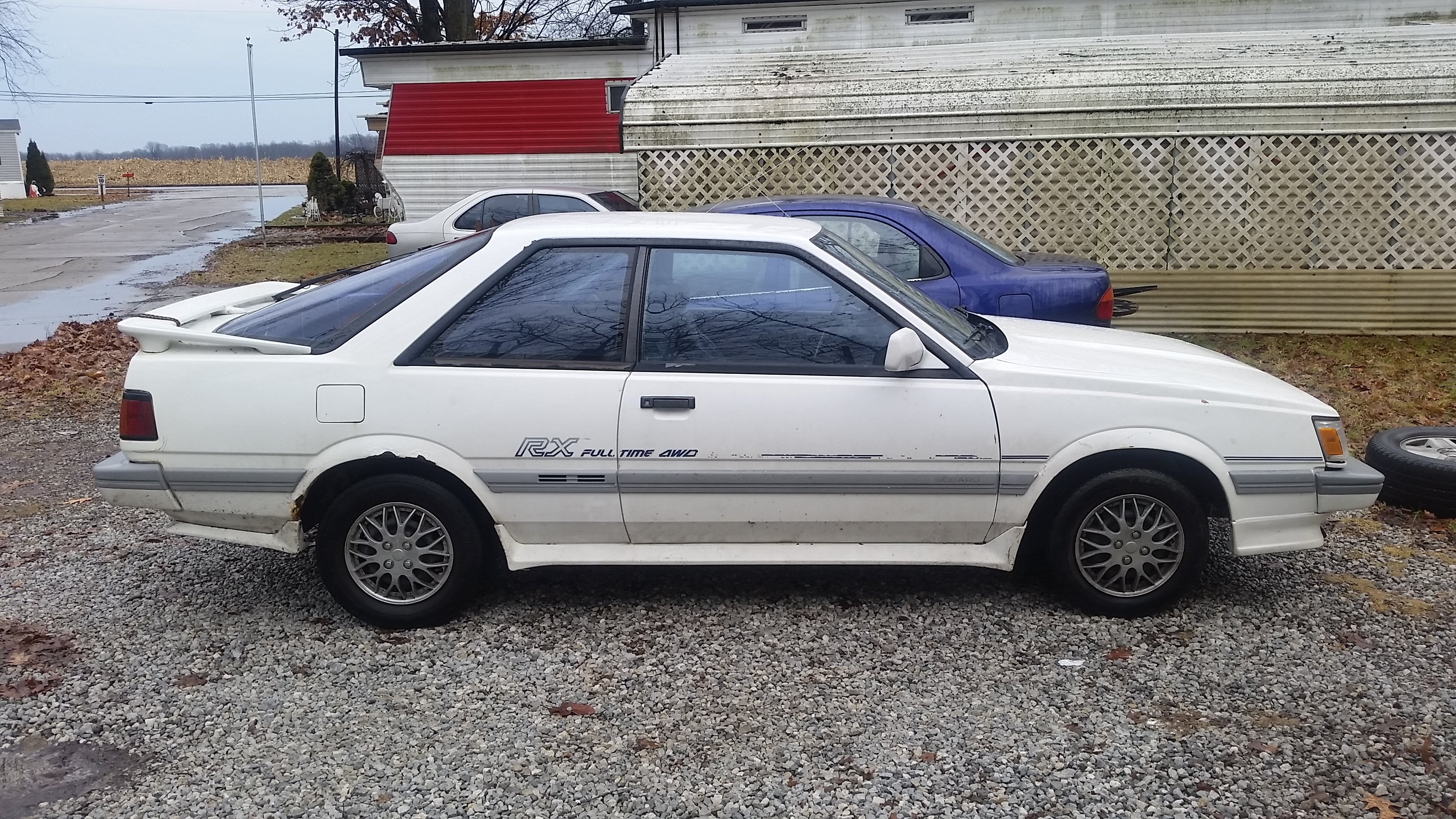

So I couldn't find much info regarding how to bypass a blown turbo, so I thought I'd document my plan so far. To give the run down on my poor rx the title gives the basics. It has about 183k miles and when I got it a year ago it had spent about 2 years in a barn drained of coolant (due to a coolant leak on the turbo). Immediately I performed an oil change, filled it with coolant, changed the battery, pulled the plugs cleaned and gapped them, added dry gas and filled the tank from a quarter to full with high octane to ensure there was no water issues. Now fast forwarding to now... I was headed home from work when I noticed the turbo light wasn't coming on. Didn't think too much about it till I attempted to make it come on. I begin hearing a whirring noise that started scaling up. I let off the gas and it kept going for a second till a phoosh sound happened and I began a mosquito raid. Smoke poured out the back of my car so thick I couldn't see the traffic behind me. Which after thorough inspection was deemed to be the turbo was the culprit. Pulled it out and found the turbine half sitting in the down pipe. I Can't find any turbine shafts for the VF48612 IHI Turbo. I've found some possible rebuild kits which would be necessary if I could get the shaft and maybe the compressor wheel (not sure if it kissed the housing or not). Nor can I find a replacement turbo and I'm not willing to go the upgrade route to the TD04 (each post I read about that swap on an ea82 ends usually a few months later with bad bearings). So to wrap this up, like I've said I cant find much on bypassing one. This is my plan. The turbo being removed and pulled apart to get the compressor wheel out. I plan on filling the void where the shaft would be with permatex ultra copper gasket maker. Then fill the area in the bearing housing where the oil supply comes in as well. Then plug the oil supply line, reconnect the coolant to the housing, leave the waste gate valve disconnected from the turbo and reinstall the turbo to the exhaust up and down pipes and the air intake pipes. I understand doing this will drastically reduce my cars power but if it works will allow it to run and be driven. Sorry for the long post and if this has already been covered in another thread. If this has been covered already please link it in the comments so I can take a look. Any and all help/advice is greatly appreciated. Thank you very much.
