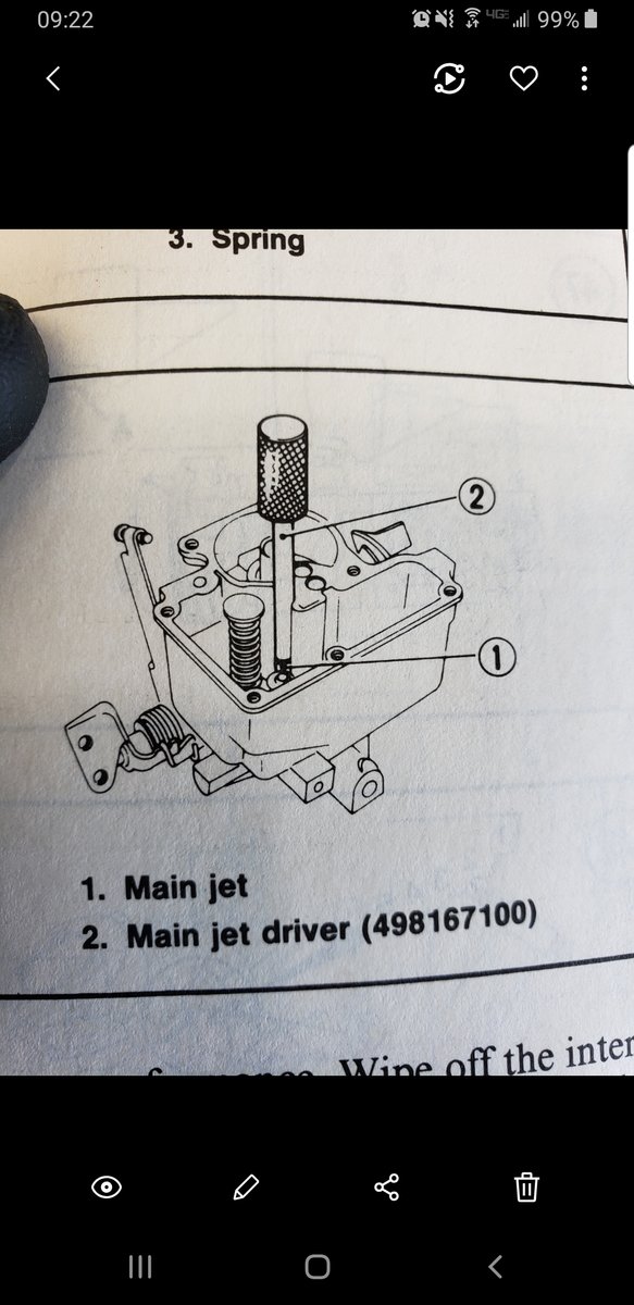

  1. Is there a solution to removing the main jet out of the TYF carburetor? I rebuilt the carburetor but without removing the main jet and after assembling and installing the unit the BRAT still will not run. My fear is that I still have crud in that passage.

  7. Thanks for the info. I took the carb off and took it to my shop I work at and flushed it with warm solvent and gave it a good shaking to get all the solvent out but once I reinstalled it I had the same issue. I'll tap it with a soft hammer then like you said I have nothing to loose by taking the top off.
