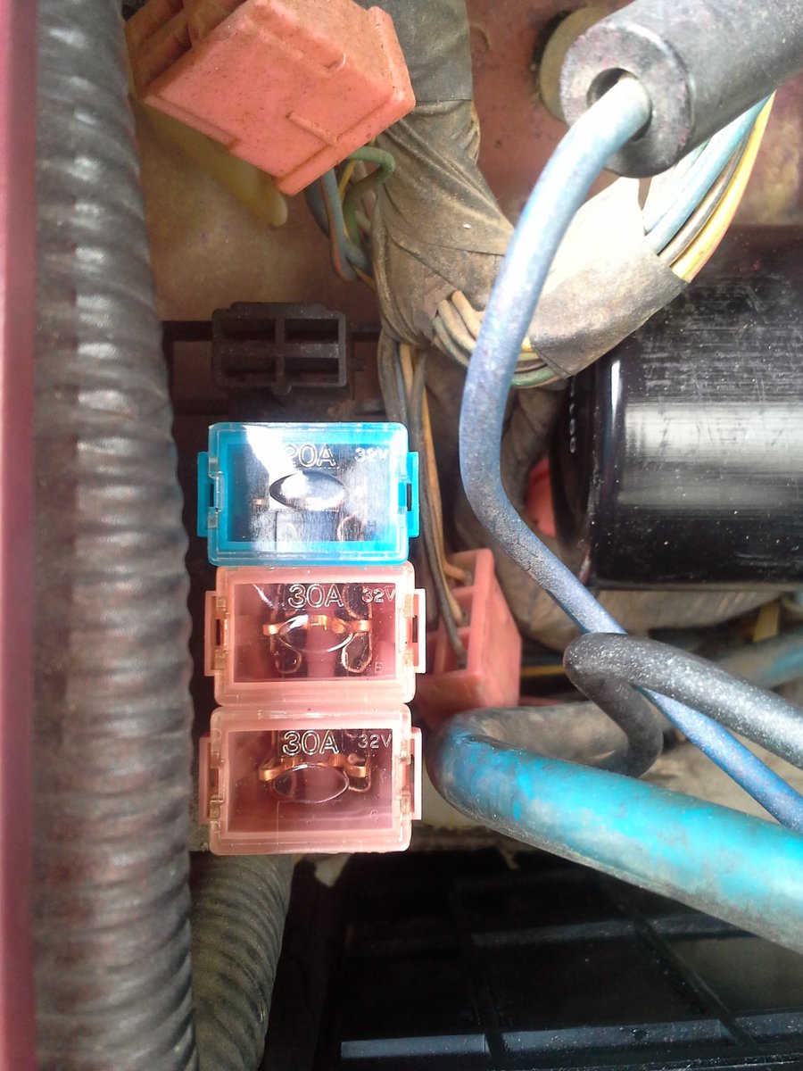

  3. Seems to be fixed! Fusible links and starter. After pulling back the housing on the fusible links I could see all three were blackened somewhat, the red one closest to battery being the worst, and the gray plastic cover for them had a blackened ring around the inside. They arent entirely broken as far as I can tell, but if theyre not the problem they dont look good enough to keep, either. Since fusible links dont seem to be sold anymore, I used instructions from another thread (link below) and switched them out for 30A (substitute for red fusible links) and 20A (sub for green) cartridge fuses. People in that thread are talking about snagging these from the junk yard, so I'll also mention that at the store they told me I could use wire to connect Female Quick Disconnects (same ends that are on the fusible links) to 30 and 20 regular fuses same as what's inside the car. That could be nice because then the original cover would still fit. It doesnt fit over the cartridge fuses I bought, but I'll keep them as is for now. After switching these out the starter was still just clicking, and there was still buzzing coming from there when the key is in the headlights position. Wacking the starter with a hammer while attempting to start the engine got it trying to turn, which is how we diagnosed the bad starter. I dont understand how it got damaged all the way down there with positive battery and ignition coil disconnected, but replacing it did the trick. The buzzing under the hood near starter is still there when key is in headlight position. Thanks for all the responses!

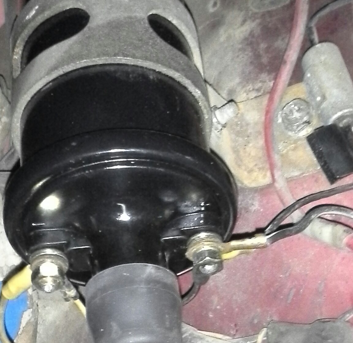

  6. Hi everyone! Long time reader, first time poster. New owner of an '83 BRAT! I'm not a mechanic so please bear with me and try not to judge me too much over here! Got this truck recently and a mechanic friend suggested I switch out the ignition coil for a newer one. There was nothing wrong with the one it had, but he said it looked old and was basically a "why not" kind of thing, and simple to do myself. I followed advice from another post on here by someone with an '84 BRAT. Two yellow wires to negative, three black wires to positive. Found that post because i could have sworn there were only 4 wires there when I started! I only unhooked positive side of the battery, and disconnected the plug and wires for the coil. When trying to loosen the lower bolt for the strap that is around the coil, the other end of the wrench also touched positive battery terminal. It sparked, I jumped back. Finished up with the whole battery removed. When I tried to start it, it sounded normal for half a second then just clicked. Lights still work, no fuses blown (I only looked at the ones inside by the steering wheel, if there are more please let me know,) but now it just clicks once per attempt, no sound like it's about to start. Did I damage the battery by shorting it? Everything I've searched so far makes it sound like the wrench didn't have long enough contact for that to be the case, and when my battery has died on past cars the symptoms were different. I'd try jumping it but am being wary in case there's something else I did wrong, possibly with the ignition coil or another part becoming damaged when I shorted it? Do I feel so dumb? Yes. From now on i'm going to be following some good advice I already knew: If it aint broke, dont break it! I appreciate any help with this. Thanks for a great forum!
