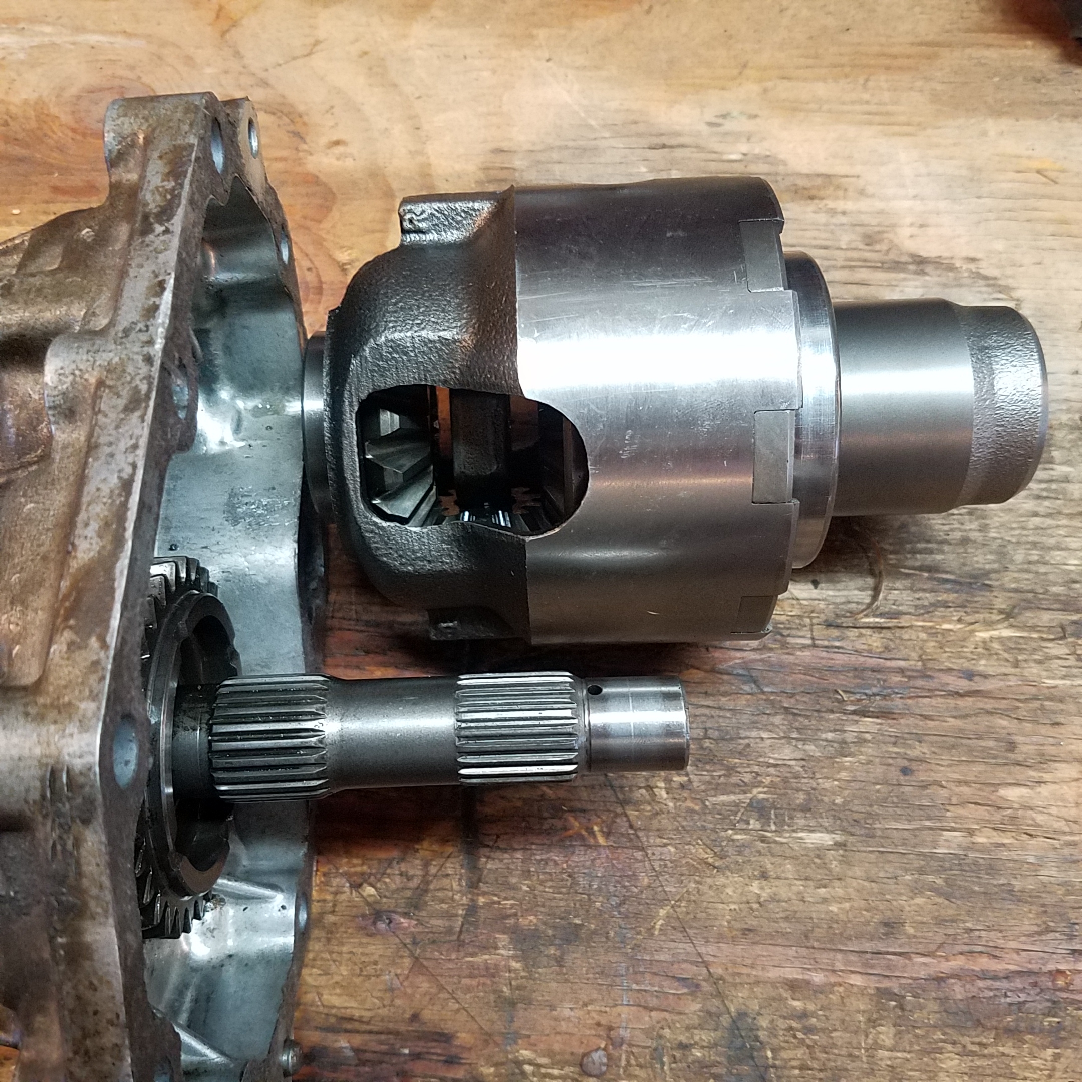

  1. OK, problem resolved after taking the old center diff apart. The rear drive transfer shaft, shown with the two spline sections, doesn't actually engage with the front drive beveled gear in the differential. The bevel gear, and the front drive shaft do rotate with respect to the spider gears and the rear drive beveled gear (open differential). Just not in my specimen. I needed to use vice grips to rotate the front / rear drive shafts because my viscous coupling device is nearly frozen. I heated it up a little to 120F, and it locks up completely. Put a used center diff back in the tranny, and it seems to work fine. For prosperity, here's how to check if your center diff / LSD is failing. Jack up the vehicle from the side, so that the front and rear wheels on that side are off the ground. Parking brake off, tranny in neutral. Rotate the front wheel forwards, and the rear wheel should also rotate forward. Now put it in gear and repeat. This time the front wheel forward should result in the rear wheel rotating backwards, reverse. In neutral, the center diff housing rotates freely, allowing both drive shafts to move forward together. In gear, the center diff housing is locked by the tranny and engine resistance, forcing the front and rear drive shafts to rotate in opposite directions. When I do this, it's very stiff, but the wheels rotate in opposite directions. I'm assuming under normal conditions the two drive shafts only need to move a little, and slowly, with respect to each other
  2. Thanks for responding LTexan. I had also found those vids, but watched them all again to see if I missed something. Especially the first one. I'm going to tear my failing unit apart and see if a learn something. BTW, sliding the center diff and rear drive shaft into the transfer case, on the vehicle, is in no way as easy as that guy does it in the second vid. Took me about an hour... Just can't get around the rear drive transfer shaft locking the front and rear side gears together, inside the differential. On the bench, when I insert this shaft, the differential is locked together as if it's one big fused shaft. But there's no way that's how it was designed to work.
  3. Yeah, I think I'm missing some something here (aka: I'm an idiot). With the rear drive transfer shaft (bottom of pic) inserted, both the rear and front drive shafts are effectively locked to each other, meaning there is no differential action at all. They are both locked to the center diff housing as well, negating the need for any kind of LSD. I'm going to replace the unit with the spare from the old tranny and put it back together. But it drives me crazy to do that not understanding how it's supposed to work. If anybody has any insights, please let me know.
  4. Still working on this. The tranny I removed is a TY752VAAAA. Final drive ratio of 4.11 according to the chart that is all over the net. The tranny I put in is a TY752VA2AA. It's not on the chart, but numerous sources online indicate it is also a 4.11 (Google says so, so it must be true?). By rotating front and rear wheels in various configurations, it looks like the center differential is functioning smoothly and easily. The viscous coupling device seems to be very stiff, compared to the one I have on the bench. Before I tear the center diff / VCD out, I have a question maybe you gurus can help with. Attached is a picture of my old center diff, on the bench. The rear drive shaft is connected through the drive transfer shaft, shown at the bottom. This shaft has two different spline sections, which fit into each of the beveled side gears inside the center diff. Not the spider gears, but the ones connected to the front and rear drive shaft. This locks the two gears to each other, which seems to defeat the whole function of the differential. It's like it's got a center differential, but it's locked. Any insights?
