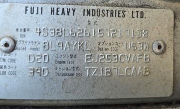

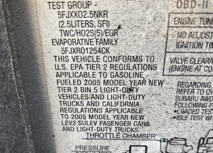

is dealer wrong? cancelled my PCV valve order
I ordered 11810AA100 which says its for U5. I put my vin into the order form and they cancelled it and said I need 11810AA040. When I searched online it said U5 is california vehicle so isn't that what I have?
