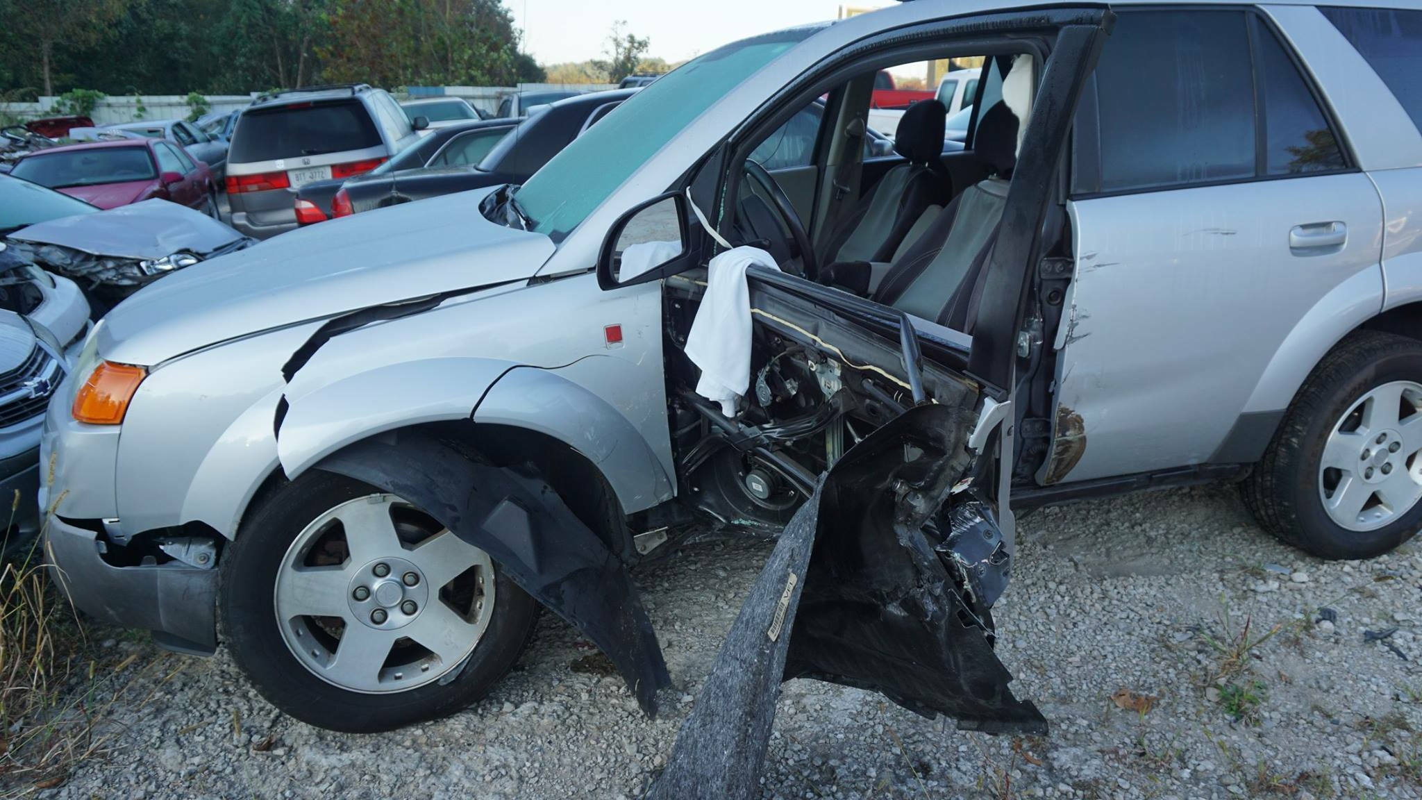

Fuji replied to Fuji's topic in 1990 to Present Legacy, Impreza, Outback, Forester, Baja, WRX&WrxSTI, SVXThanks for your kind words- The Saturn had side curtain air bags and luckily my wife was not hurt more severely but the accident did result in her having to have plates in her neck and to this day she has to take medication for the nerve pain. I am not sure what happened to the woman who hit her but I do know she was not killed. She spun out and went into a shallow ravine and hit a tree (A Rav 4). My wife spun out into the opposing traffic lane where the car ended up and luckily she was not struck. If she had been it would of been a lot worse. She was removed from the vehicle with the jaws of life. Worse thing that has ever happened to us. On the car- I realize I am taking a gamble doing the minimum but I have never had 1) an oil pressure light come on 2) check engine lights 3) no timing chain shudder or noise etc. I will pick up the car tomorrow and hopefully the major oil slick will be no more!

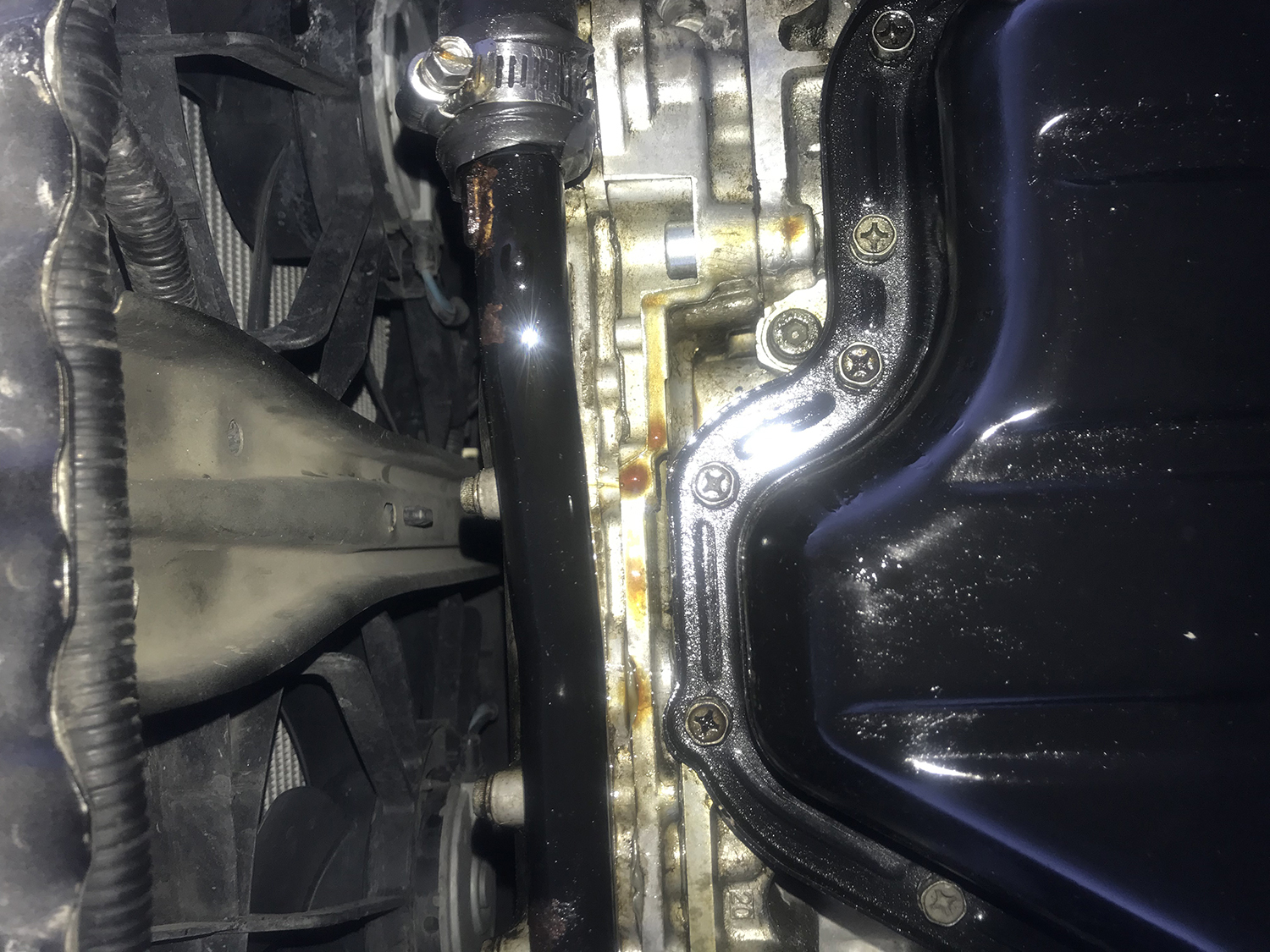

Fuji replied to Fuji's topic in 1990 to Present Legacy, Impreza, Outback, Forester, Baja, WRX&WrxSTI, SVXI cleaned the bottom of the engine where the leak is AND I checked the header contact areas on the passenger and drivers side (NOT even a hint of oil on either side). I did find the point were it is leaking along where the timing chain cover marries to the engine and interestingly it is dead nuts by a bolt and it ONLY leaks at that one point (see pic). It will be so expensive to repair that I am thinking of trying to research a resilient silicone or epoxy that might stop the leak from the outside. I know that is a long shot and sort of mickey mouse but it would save me so much money. What do you think? Thanks

Fuji replied to Fuji's topic in 1990 to Present Legacy, Impreza, Outback, Forester, Baja, WRX&WrxSTI, SVXThe pic is while the car is not running- it barely drips when not running but when it runs it has a constant drip. It is really hard to shimmy under the car when it is running and see where it drips from but I think if I got a piece of plexiglass I could lay beneath it and maybe help me see it. I installed a new PCV valve and I thought it might cause a decrease in the drip due to less oil pressure but if it is it is not much.
