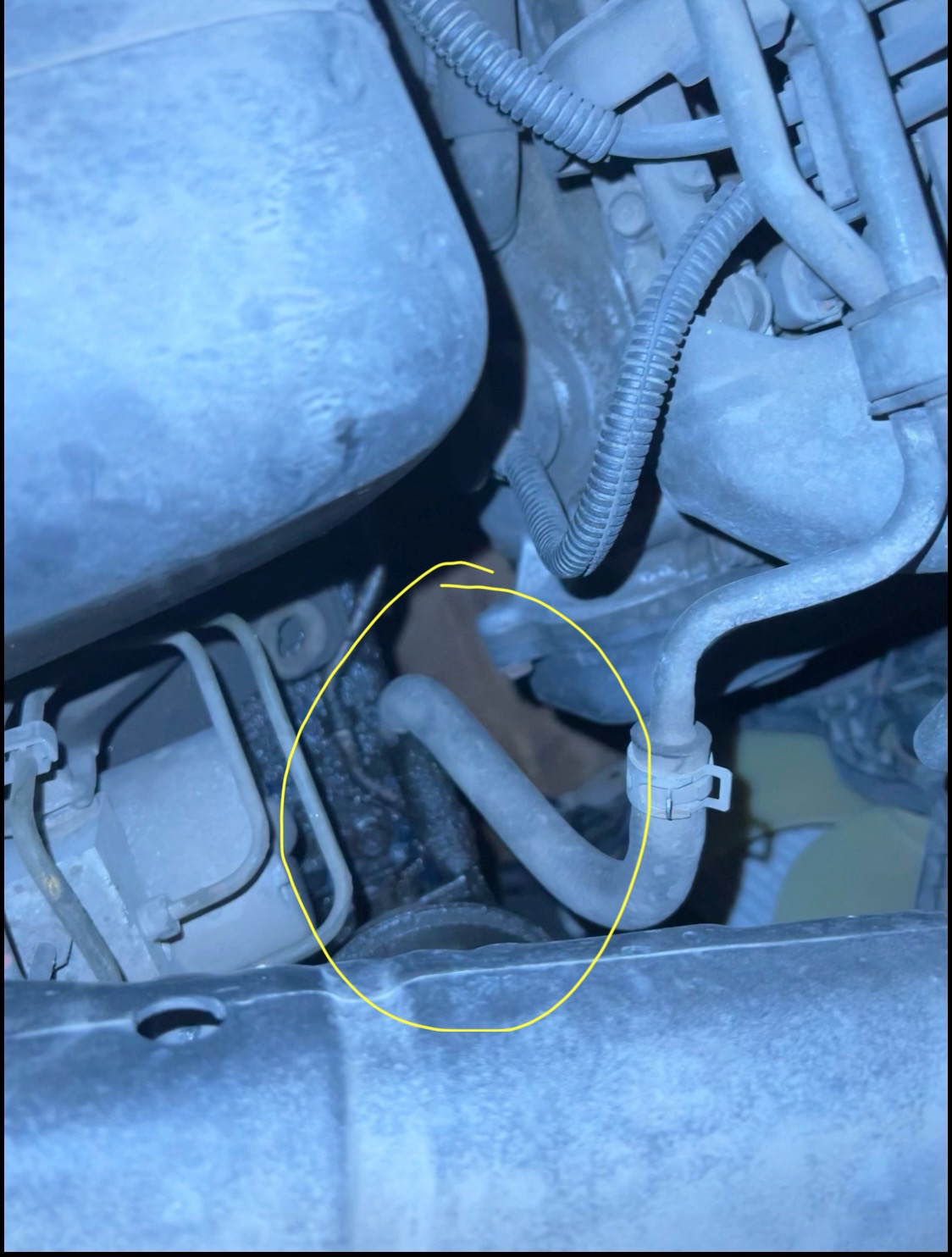

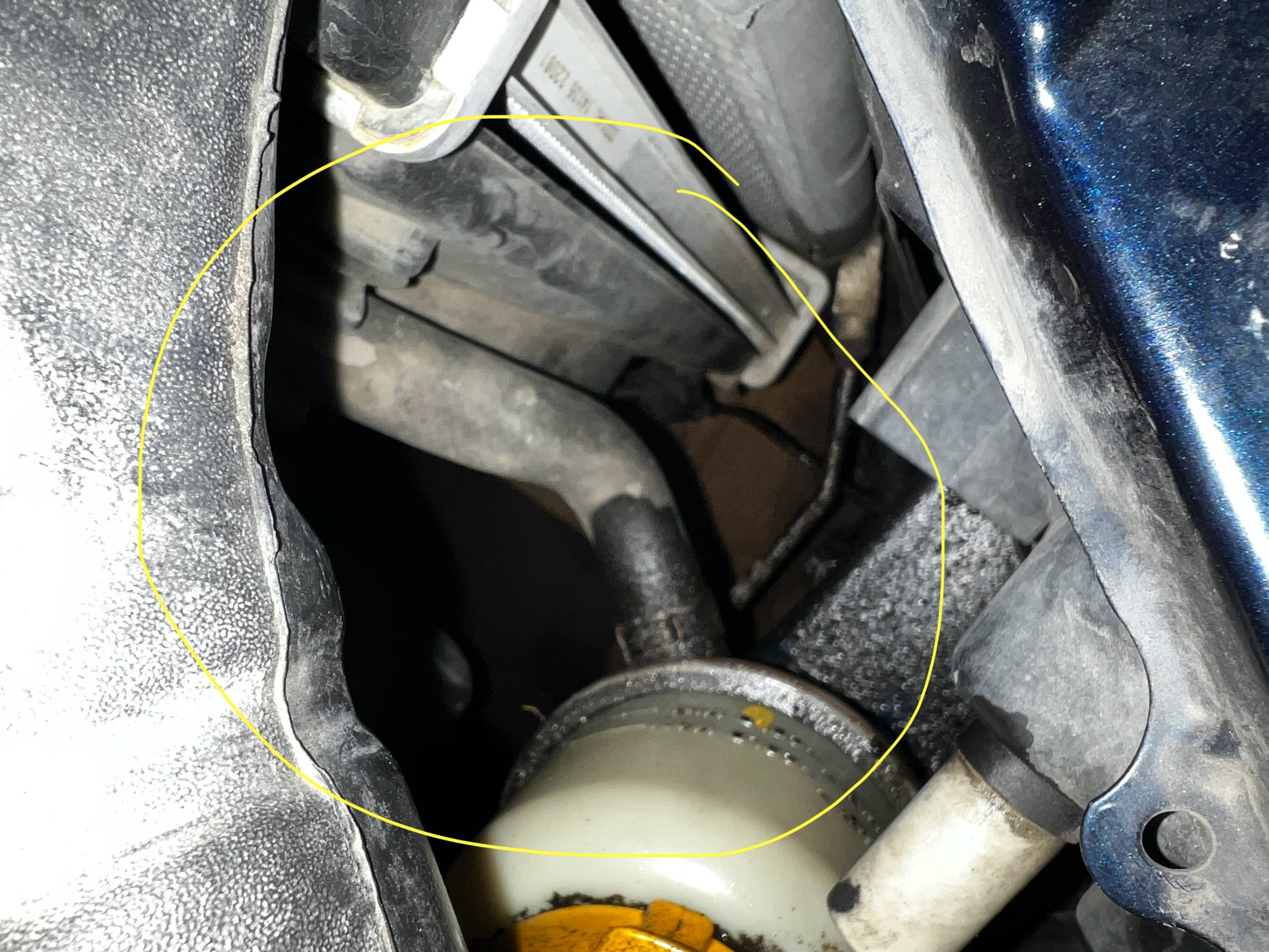

I posted about this but am making a new post. I oreviously thought there might be a leak in the power steering hose that connects to the reservoir or the reservoir itself, but I took everything apart and didn’t see any cracks. After some more testing it looks like the leak is coming from the top of the reservoir, like out the cap itself? What could the problem be? I saw online that there may be a missing O ring where the hose from the reservoir and pump connect. I’ll attach some pictures. Thanks for any help.- '04 Legacy Power Steering Reservoir

subie99 replied to subie99's topic in 1990 to Present Legacy, Impreza, Outback, Forester, Baja, WRX&WrxSTI, SVXI see what you’re saying. There’s a thicker rubber house towards the front of the reservoir and then a thinner one towards the back. I took these pics before work. I believe the thicker one is the culprit and the one you’re talking about. I really appreciate the insight !! Let’s see how tomorrow goes 😮💨- '04 Legacy Power Steering Reservoir
subie99 replied to subie99's topic in 1990 to Present Legacy, Impreza, Outback, Forester, Baja, WRX&WrxSTI, SVXOkay gotcha I’ll be sure to keep that in mind. By chance do you know what the hoses would be called? From my knowledge , there’s a high pressure hose and a low pressure hose- '04 Legacy Power Steering Reservoir
