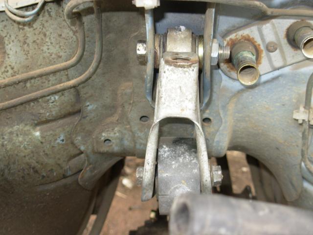

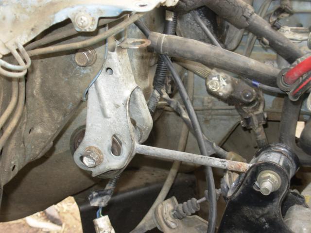

what i did was took xt pitch stopper mount and legacy pitch mount also and hardware. took the leg pitch stopper mount flipped it upside down and put to firewall mount spread one end to accept big end of legacy stopper. drill new hole about 1\2 to 3\4 of an inch back from original hole and bolt it all together sorry if this is a confusing write up not a computer person ill try and attach photos next. i haven't tried it out yet still have exhaust and wiring to finish up
also i cut the skinny end off of original stopper and used for spacer and couple of washers.the legacy stopper was perfect length
That's clever but it'll pivot and won't stabilize the engine as it should. Using the XT mount on the tranny's good but you'll be best off just lengthening the connector in the middle.
no its cammed against existing firewall stopper i'll have to get it running to see how strong it is .right now it won't move
