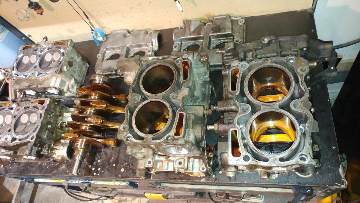

I am looking for some engine builder advice. I have a EJ205 that came out of a 05 WRX with 144k miles. The engine was still running strongand still making boost but was very dirty on the outside and i did not know the history so I decided to pull the engine and break it down.
The engine came apart pretty easy, no broken or rusty bolts. No visual signs of damage.
At this point I will measure everything as specified in the FSM and figure out what machine work will need to be done.
