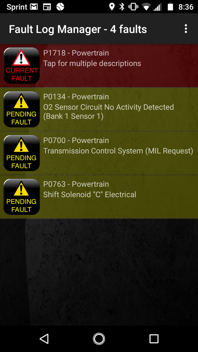

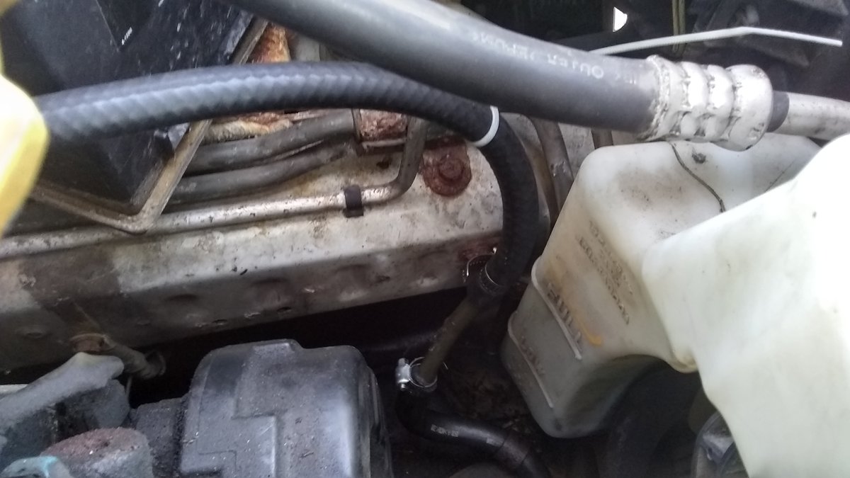

billyfrancis40 Posted September 22, 2019 Author Share Posted September 22, 2019 Here all are codes today as of rehooking up battery P1718,p0134,p0700,p0763 Car is a 08 legacy none turbo with a 4eat trans I replaced the internal filter not the external one yesterday with about 4 qts of new fluid. Pan looks good but does have a very little dent on the external filter. At oil light flashes none stop and won't go away for nothing . No noticable wire damage but not sure where tcu is I think under dash by steering column and I followed those as well look ok. Got car from my dad which is original owner and he had it maintenance at subi deal for life of car. Car did sit for about a yr. He's had all done to it heads belts trans serviced and so on. Really confusing me. Really all this happened when a trans cooler line was leaking and we just cut where it was leaking and ran rubber hose instead of the metal rusty line inside the engine bay to the radiator. Since then the light has flashed like crazy. Thx Link to comment Share on other sites More sharing options...
idosubaru Posted September 22, 2019 Share Posted September 22, 2019 Don’t know. Wonder if rust could get in the trans and clog stuff up? Seems unlikely but are those lines pre or post filter? Valve bodies occasionally fail on 2005+ EATs. Link to comment Share on other sites More sharing options...
