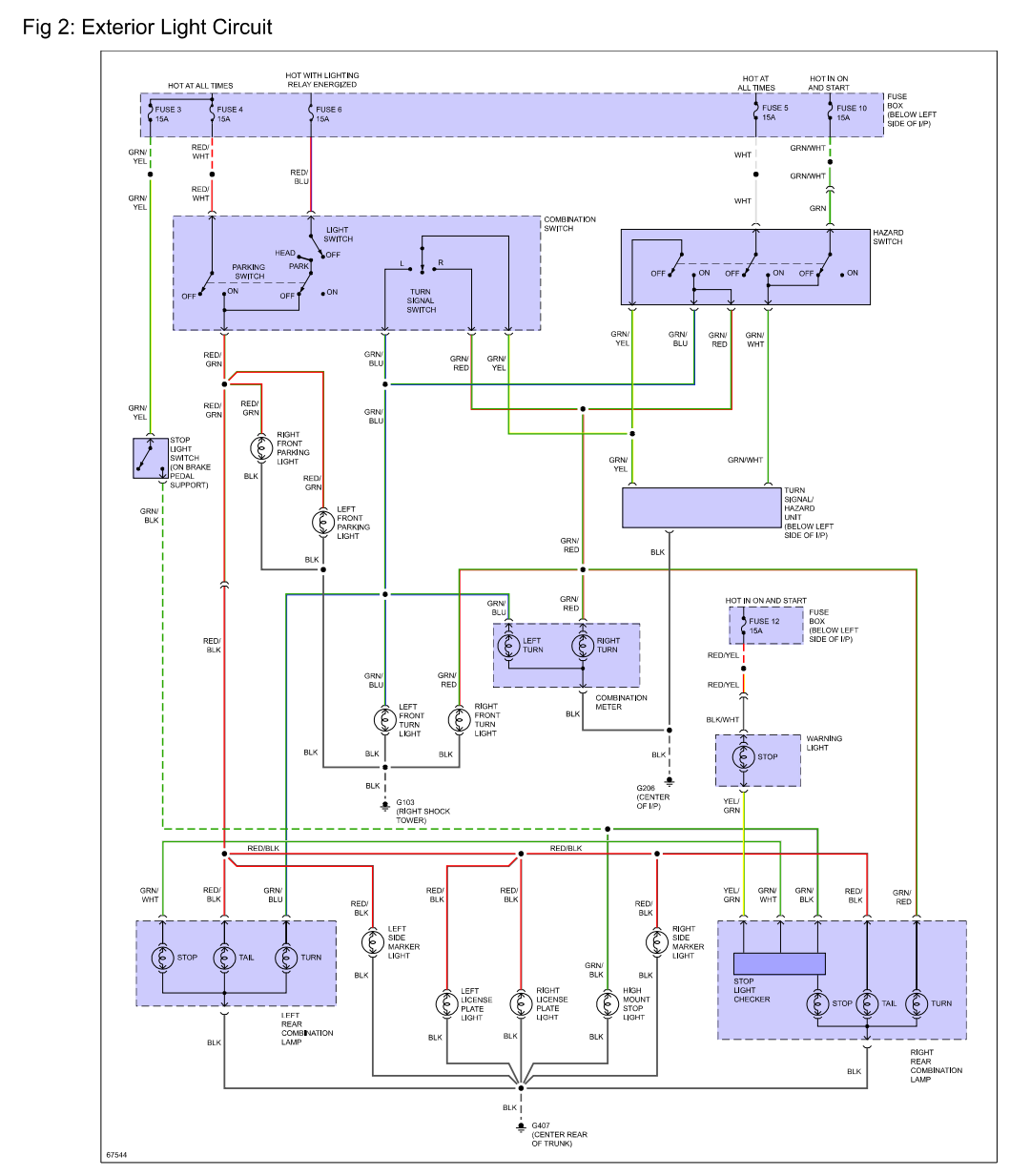

  • Turn signals don't turn on
  • Hazards don't turn on
  • Dash turn arrow indicators do not illuminate when flashers ought to be on
  • The flasher relay is not clicking
  • The 'Stop Lamp' dash light is lit (but brake lights and headlights are fine)
  • Horn doesn't work
Here is what I've done to try to solve the problem:
  • replaced flasher relay (no change, no power getting to the line per the test light)
  • replaced all hazard/blinker bulbs (no change, still no light)
  • tested all fuses in box and the four fusible links under hood (all were fine, the hazard/horn/clock fuse is fine, clock works)

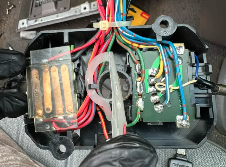

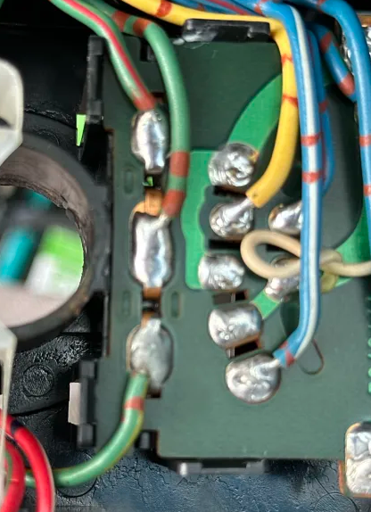

I'm at a loss as to what to do next other than dig further into the dash and to trace the flasher wire back further (not fun). Prodemand is not helpful.
