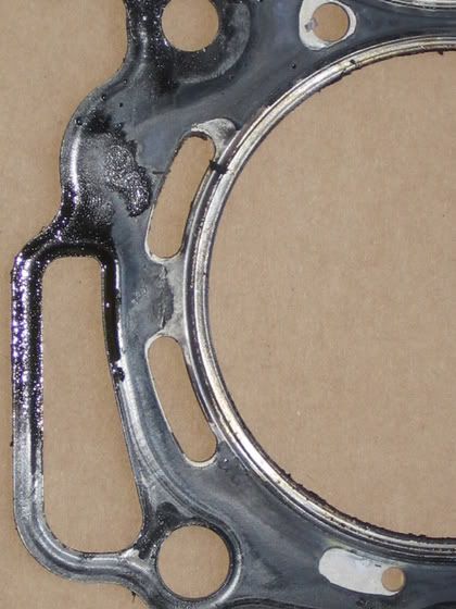

a97obw Posted February 2, 2006 Author Share Posted February 2, 2006 The "ridges" were definitely high enough to catch a fingernail, and the grooves as well. The grooves are in the case and the ridges were on the head I believe around the outside perimeter of the cylinders. Here is a photo I took when I removed them---I should have taken a few shots after I cleaned them up----but today I took them to the machine shop and they surfaced both of them 0.004" (four thousandths) each. They have an absolute mirror finish to them, I'll see if I can get a picture of them to this thread in the next day. Anyway, here is where I think the gasket failed, below the front passenger side (I'snt that #1? I don't have my manual handy and it sure isn't the same as the air cooled VWs and Porsches!). <img src="http://i4.photobucket.com/albums/y141/Huffmeister/IMG_0680.jpg" alt="Image hosting by Photobucket"> And the offending gasket! <img src="http://i4.photobucket.com/albums/y141/Huffmeister/IMG_0682.jpg" alt="Image hosting by Photobucket"> Link to comment Share on other sites More sharing options...
cookie Posted February 2, 2006 Share Posted February 2, 2006 Sure looks blown. Link to comment Share on other sites More sharing options...
