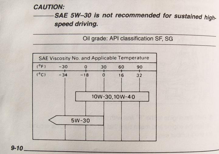

JasonDairs Posted September 13, 2014 Share Posted September 13, 2014 I don't have the owner's manual so I've been looking for what Subaru recommended for my 1994 Subaru Legacy Wagon. I'm curious as to what they specifically recommend. Quote Link to comment Share on other sites More sharing options...
Fairtax4me Posted September 13, 2014 Share Posted September 13, 2014 If you live in the dessert (100°+ temps on a regular basis), 10w-40. Anywhere else, 5w-30. Quote Link to comment Share on other sites More sharing options...
BB's93LegacyL Posted September 16, 2014 Share Posted September 16, 2014 (edited) Here are Subaru's specified oil viscosities, taken from the owners manual for my "93 Legacy Wagon. Click on the thumbnail to enlarge the photograph. I don't know if Subaru made any changes to the specified oils for the '94 model year. Edited September 17, 2014 by BB's93LegacyL Quote Link to comment Share on other sites More sharing options...
Stevo F Posted September 16, 2014 Share Posted September 16, 2014 I used to run our '94 Legacy on 10W-30 or 10W-40, Nowadays I run our '98 & '05 Subies on 5W-30 only. Quote Link to comment Share on other sites More sharing options...
JasonDairs Posted September 20, 2014 Author Share Posted September 20, 2014 Thanks for the manual pic. I live in Minnesota so I may change it to 5W-30 for the winter. Quote Link to comment Share on other sites More sharing options...
