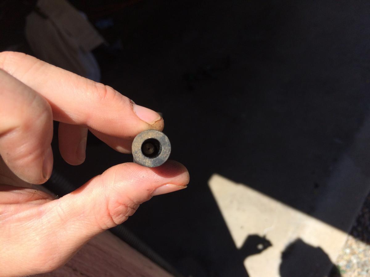

ihscout54 Posted June 22, 2015 Share Posted June 22, 2015 (edited) This is a tube with an orifice installed. Those ports I mentioned really need to be open with these vac lines installed. The carb wont run right and will be pig rich with them simply plugged. Edited June 22, 2015 by ihscout54 Quote Link to comment Share on other sites More sharing options...

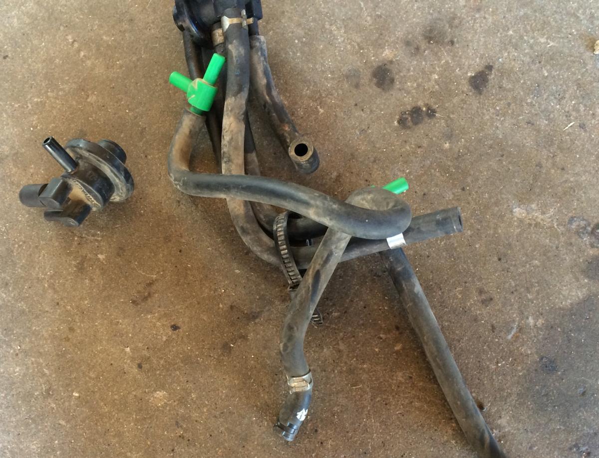

ihscout54 Posted June 22, 2015 Share Posted June 22, 2015 This is the mess Im talking about. Its a confusing spaghetti pile. I took out the tees and ran the lines with the orifices directly to the control valve and then to the air cleaner. The control valve is actuated by manifold vacuum that is regulated by a thermo valve. I tested the vcv with my vac pump and tested the thermostatic valve with a torch. They both checked out so I kept them. I will post more info on this when Im home if anyone is actally interested. 1 Quote Link to comment Share on other sites More sharing options...
Sapper 157 Posted June 23, 2015 Author Share Posted June 23, 2015 Yes Please keep the info coming!! That spaghetti mess is exactly why I cant figure out which tubes go where. Your info thus far has been very helpful ihscout! Quote Link to comment Share on other sites More sharing options...

djellum Posted June 26, 2015 Share Posted June 26, 2015 (edited) heres a link you may find interesting. http://www.ultimatesubaru.org/forum/topic/127365-simplifying-the-ea82-hitachi-hose-nightmare/ it deals with EA82 and not EA81's, but a lot of the emmissions reduction stuff will be the same. also the carbs have most of the same ports, they are just moved around a little. might just find that gem in there somewhere. i notice in one of your pics that there is still an open line, what is it for? couple of things from doing the delete I did (full delete, only 3 vacuum lines remaining). gas tank hoses - make sure the input for fuel and return line are correct. make sure that the tank vent tube is not blocked or plugged into vacuum, it needs to be open to air (or charcoal canister if you have one). the big one is that bowl vent. the vent controls the pressure in your fuel bowl, and it needs to have the right pressure in there or you will never get it to tune even remotely well. the choke shouldnt engage unless its cold, id just unplug it till you get it running correct, then worry about it after. theres no real reason for increased mileage from eliminating the parts of the hitachi that make it run well. there should technically only be lossed efficiency, my guess is that the secondaries are not working or your running terribly lean which is not good overall for the motor. cant remember exactly but I think the secondaries are vacuum operated, but the passages are internal to the carb. not real sure about that last bit so double check. strange question, but did you adjust the mixture? its adjustment can be hidden behind a roll pin on the EA82's and you cant see it. if you mess with the carb lines and remove items you will need to readjust. all those hoses arent emmissions related they are what the carburetors uses to run the car. theres very little actual emmisions stuff on these, pretty much just the cat and the ASV system. the rest is actual neccesary parts to running the car and deleting things will not gain any performance increases above stock. now the reason we delete things is when they fail and are too much work or cost to replace. we can get 80% performance with 30% of the hassle and we settle for that until we can get a better solution (true fix or a weber). Edited June 26, 2015 by djellum Quote Link to comment Share on other sites More sharing options...
ferox Posted June 26, 2015 Share Posted June 26, 2015 Looks like you still have way too much useless stuff in your engine bay. Don't use the steel lines under the manifold. Hook your vac lines straight to whatever component they go to. I run the charcoal canister. The only reason not to, is if the vacuum valve on the canister itself is degraded and you don't want to but another canister...doesn't have to be a direct replacement. I'm using one for a Jeep $30 Rockauto. You have the ported vac nipple for the canister/egr hooked to the steel transfer line that runs under the manifold. Is it connected to the canister? If you're not using it, cap it at the carb with vinyl caps. If you are, run a direct connection. You can't diagnose a problem like this with so many unknowns in your connections and obsolete components. Here are my pics again, but maybe use them to see what's not there Quote Link to comment Share on other sites More sharing options...
