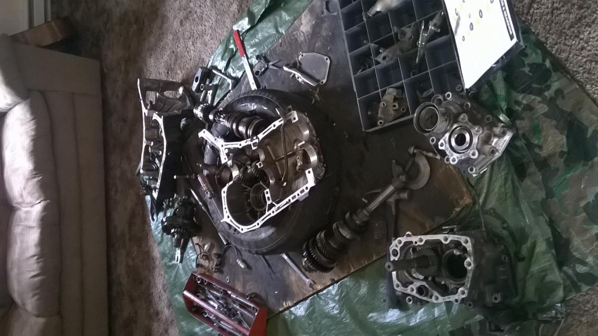

peacewize Posted August 26, 2015 Author Share Posted August 26, 2015 I have this hear and a bunch of stuff for torque specs gear ratios et. Kind of hard to make out, like i said first time doing this and im really excited to figure out how this actually works. Which gears exactly change for low range? ive been playing with it and i think i figured out how the gears 1 through 5 work but the low range and diff lock thing dont quite make sense yet. Also its from a turbo rx so it already has the larger stubs. Thanks Quote Link to comment Share on other sites More sharing options...
wagonist Posted August 27, 2015 Share Posted August 27, 2015 You've posted pics of a part time 4wd, single range box Quote Link to comment Share on other sites More sharing options...
wagonist Posted August 27, 2015 Share Posted August 27, 2015 But on the first pic, the shaft in the top left is cut into 2, and an extra shaft is beside it. There is a gear at each end of the 2nd shaft, plus corresponding gears on the main shafts. in high range, the synchro locks the 2 shafts together, in low range, that synchro unlocks, and a synchro on the 2nd shaft locks so it uses the gears & therefore the 2 input shafts will spin at different speeds. for the centre diff, it's like a normal diff in that it has pinion gears inside, but on the outside, the crown wheel & pinion are in line, instead of being at 90 degrees. There is a dog tooth sleeve on the outside of this diff, so when locked, it locks the 2 output shafts together. Quote Link to comment Share on other sites More sharing options...
peacewize Posted September 11, 2015 Author Share Posted September 11, 2015 its the best tear down ive found so far and i figure the torque specs and stuff should be similar enough. So far ive sourced all the seals except the two o rings on the front. the large one that you can see above and a smaller one which im assuming is on that shaft you mentioned because its not listed above. as far as swapping gears i think im going to hold off for now and just reseal this trans. later on i think ill give a shot a making a hybrid trans. If anyone has any info/ part number for the orings please let me know. These two orings are the only things holing me up from getting my car back together haha Quote Link to comment Share on other sites More sharing options...
