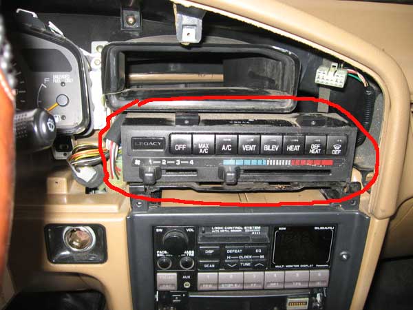

stavan replied to stavan's topic in 1990 to Present Legacy, Impreza, Outback, Forester, Baja, WRX&WrxSTI, SVXThanks for the links. One more thing: How do I take out the AC control panel? - see picture Is it bolted somehow...? It doesn't move when I try by hand.

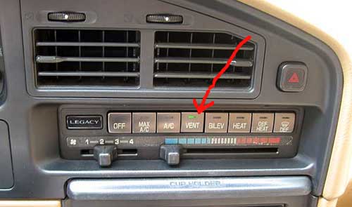

Subaru Legacy 1990 The vent system (cabin fresh air supply) usually works well. But sometimes when I push the “Vent” button I hear a sound of a vent somewhere but NO air comes out of the grilles. If I drive for a while with the “Vent” button on (green on the attached photo) at some point air starts blowing out of the grilles. What could be the reason? How can I repair it? Thanks.
