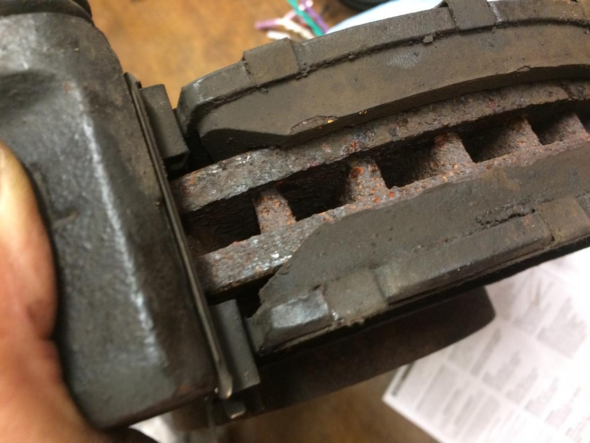

Uneven brake pad wear, overhanging friction surface. Rotor too small?
211 replied to 211's topic in 1990 to Present Legacy, Impreza, Outback, Forester, Baja, WRX&WrxSTI, SVXthis is a 2000 OBW. Both sides show similar wear and I cant remember where I bought the pads but I always buy pads and rotors new. In fact I'm pretty certain I bought the whole kit. Loaded calipers + rotors. I'll measure the rotors later today.
Tracking down a dragging caliper issue and noticed this when removing the caliper from the rotor. It looks like the rotor is either too small or the pads are too big. The upper edge of the friction material overhangs the rotor by 1/8th inch or so. Need to figure out which one of these is not like the other...
