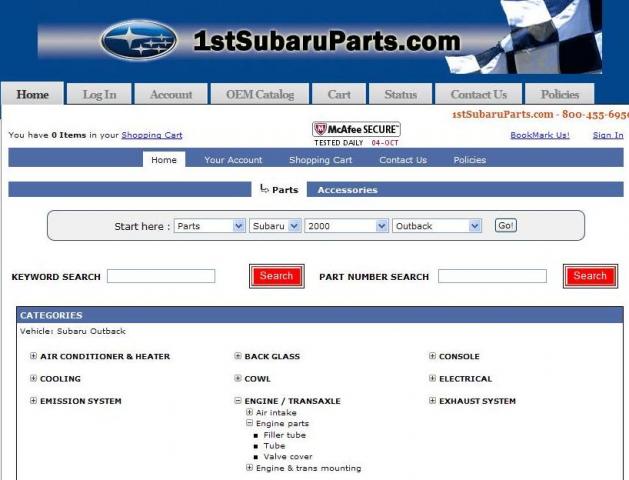

What's up with 1stSubaru.com's website?
211 replied to 211's topic in 1990 to Present Legacy, Impreza, Outback, Forester, Baja, WRX&WrxSTI, SVXIf I lick + the other catergories expand showing only one or two sub catergories, and very limited lists under that (about the same as what's shown in the screenshot). I would believe java might be a version or more behind at work but at home I keep everything up to date. FF and IE both display the same limited info. Oh well I can always just call; thats a safer method anyway.
1stSubaru.com's parts catalog list is not very extensive at all. When I select Year/Make/Model then click Engine/Transaxle catergory, it expands a subcatergory called Engine Parts with only three items listed; Filler Tube, Tube, and Valve Cover. I'm viewing in IE at work and it appears the same on FF at home. When I called 1st Subaru the other day to get a quote for parts he said that didn't sound right and his browser is displaying a lot more than what I'm seeing. I find it odd however that both my browser at work and the one at home show the same 'short list' of items. Is anyone else seeing this? Screen shot attached
