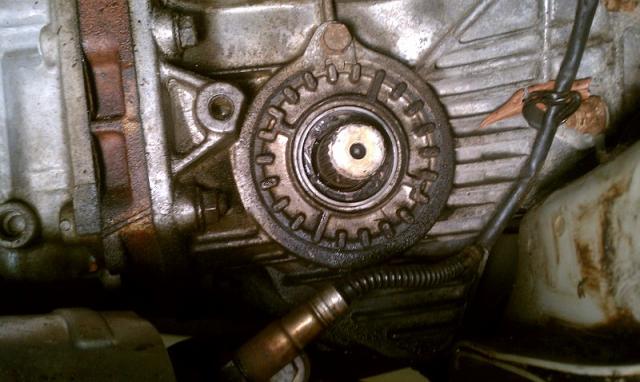

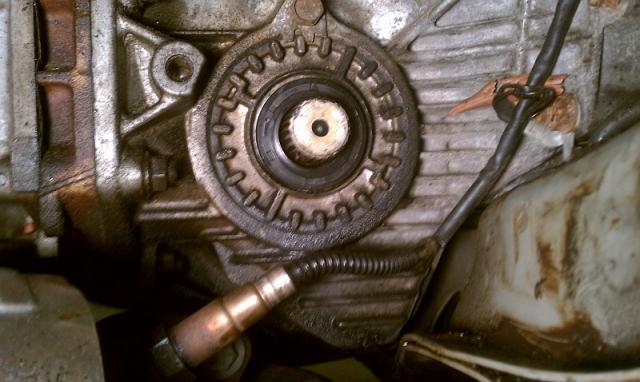

  1. Found it. Part # 806730031 http://www.subarupartsforyou.com/cp_partdetail.php?partid=15394 Three different Subaru dealerships gave me three different part numbers that I needed... and none of them were right. One was at least close but he had the manual transmission part number.
  2. I'm swapping the front passenger axle on my '02 Outback (as anyone who read this thread will know). With the axle out, Subaru recommends swapping the axle shaft seal. They gave me a part number (which they did not have stock of) and I purchased the cross-referenced part number from AutoZone. Unfortunately, it doesn't fit. Here's the picture without the seal: You can see where I believe that seal is supposed to fit - inside the inner most metal ring. We had to scrape the old seal out because it was falling apart. The new seal is clearly too big. It neither fits inside the inner ring, nor between the two rings: Only I can't figure out what seal I'm supposed to buy. The local Subaru place just parroted back the same part number they gave me initially (806732030). I verified that the auto parts place sold me the correct cross-referenced number, and checked the dimensions against the OEM part that I found online. It all checks out, so I have the seal that Subaru recommended, it's just not right. Thoughts? Does anyone have this part number? Thanks and sorry in advance for my n00b-ness! I have never had a garage to work on my car before, so I'm learning as I go.
