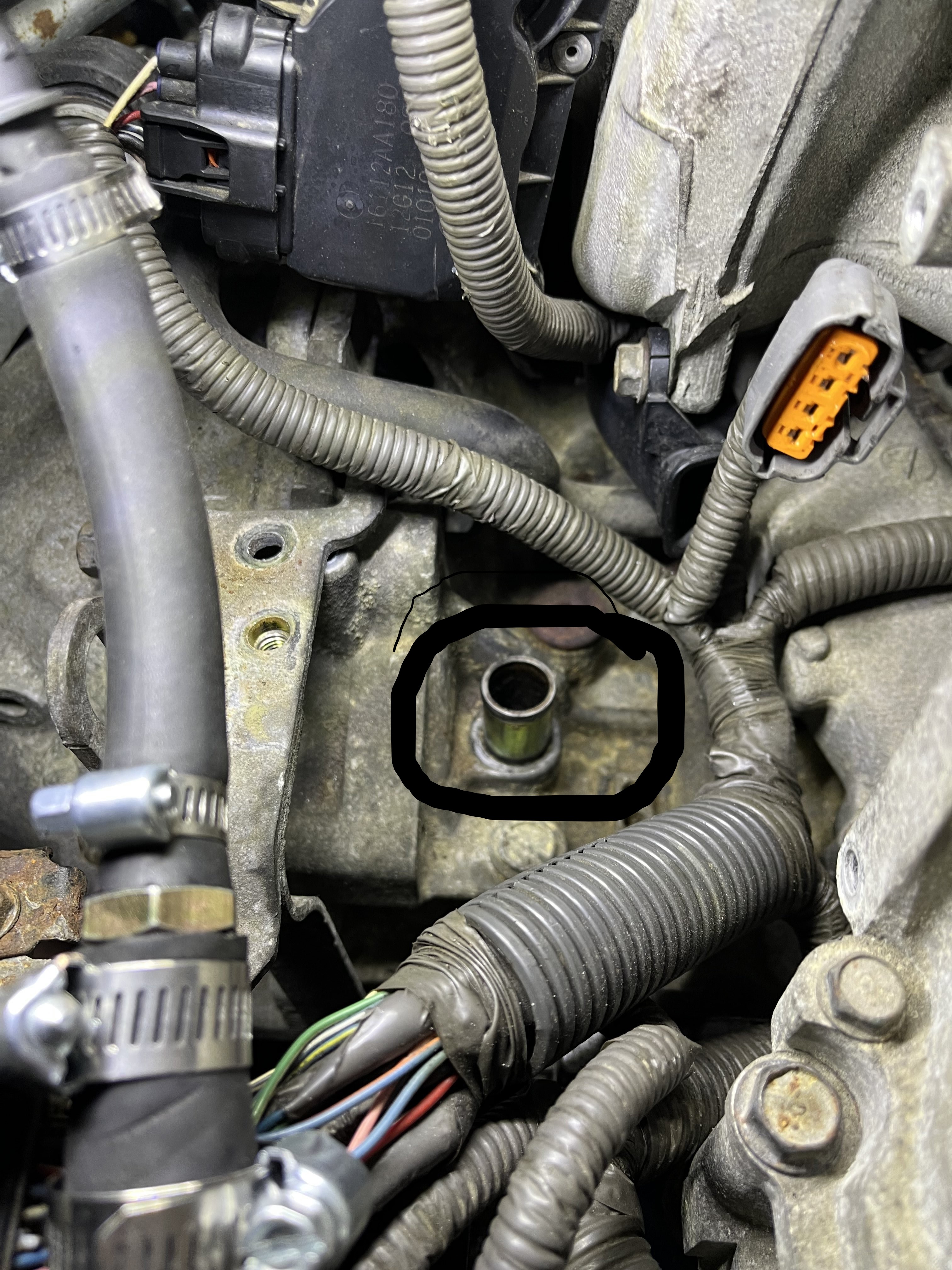

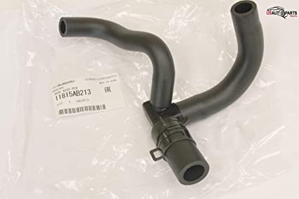

I am trying to use the short block from an 01 Impreza in an 01 Legacy L, and i ran into a bit of an issue with the PCV and EGR set ups. The short block i am using has EGR, but the car doesnt, so, i am trying to verify what size the EGR tube threads are so i can get a plug for the head. I have heard M16x1.5, m19x1.5, and m20x1.5, so which one would be the correct one? The other issue is the PCV. One the old engine, it had the fitting in the pic circled in black in the pic. One the new engine, it had the PCV valve threaded into the block, with a single hose, so, does anyone know the thread size of the PCV valve? I need to get an adapter to hook up the hose set up in the second pic, since that is what the car originally had.
