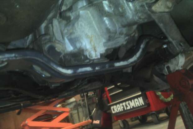

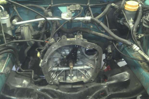

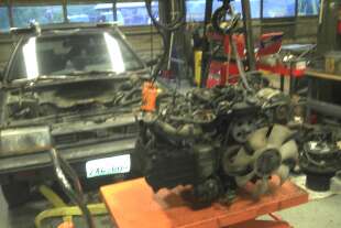

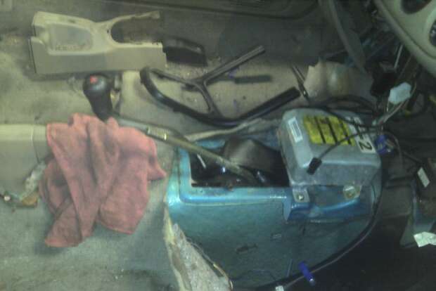

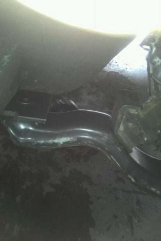

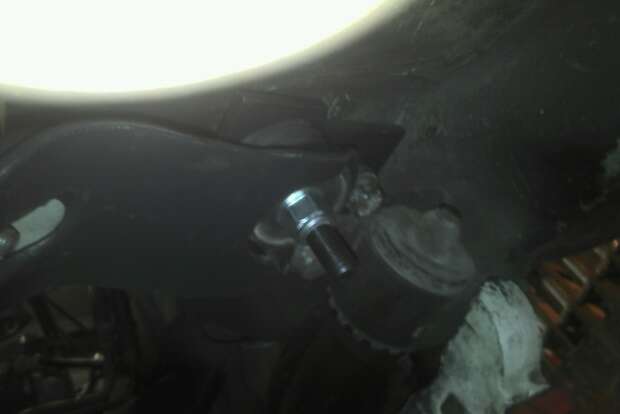

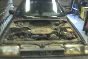

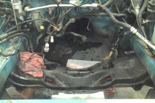

[attach]8146[/attach] [attach]8147[/attach] [attach]8148[/attach] [attach]8149[/attach] [attach]8150[/attach] -

and yes he has axles goin to pick up next weekend very exciting. i got the impreza gutted this weekend and the gl 5 spd bolted in with a freshly modded crossmember. once i go pick up the diff ill be done with drive like stuff yippy. still would like to get more infoo on the whole AT/MT ident pin on the computer. also does anyone know what will happen if i just simply remove the airbag control module -
