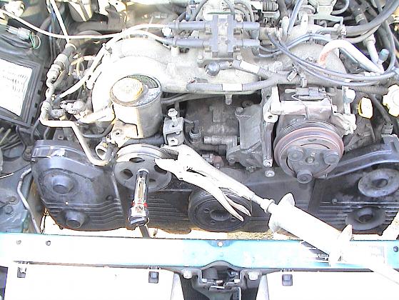

  3. My dad had a friend (mechanic) stop by. He made me put the car back together. He started the car and said it definitley was not the head gasket. He removed the thermostat and left it out. The car ran perfect (no more overheating). I am pissed because I believe removing the thermostat is not solving the problem. I am going to go to the Subaru Dealership to buy a thermostat from them according to my vin.

  5. hello everyone, I have removed a couple things from the engine this week including, air filter, intake, belts, radiator, fans, hoses, and moved power steering out of the way. I posted a gig on craigslist requesting engine removal help for $100. Today I received a offer to change my head gasket for a total of $200. The person told me engine removal was unecssasary and that all he had to do was slightly move the engine. Then he mentioned he sprays a copper spray to assure it seals. Anyways, I just want some input, should I go for it? any tips?
