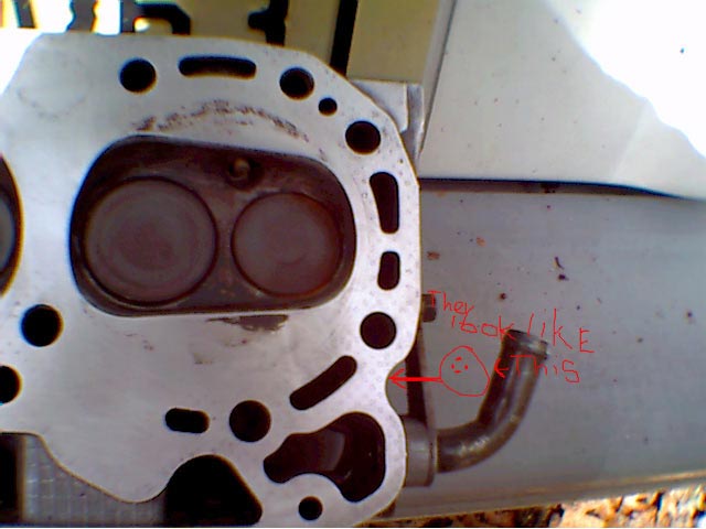

Those black marks are pits. I'm gonna have the heads milled but, the block still has some pits just like this. Not as much as the heads but, they are still there. -
Replaceing Head gaskets. Question??
wighti replied to wighti's topic in Old Gen.: 80's GL/DL/XT/Loyales...
Ok I'll try to take some pics. I can't beleive out of all the people here rebuilding engines, No one has had this happen. Just my luck. -
Well, I've already used 600 grit wet. The pits are still there. I think the only way of removing them would to be get it resurfaced. What I needto know is if these pits need to be completely gone. Has anyone had this on their heads & block before? -
I have it all apart and I've cleaned the heads and block surfaces. But, there are tiny pits in both block&head gasket surfaces w/ black specs in them. They look like tiny flowers or 4point stars, like the ones on the gaskets. Is it OK to leave tem there and put in the new gaskets? Please help! I need advice on this.
