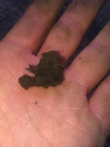

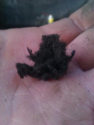

  17. About that dirt inside the starter housing. Yeah, that's exactly what I imagined it is. Dust created by the wearing of the clutch. It looks really weird. It's all black and fibery and stuff. Totally gothic. Got a tiny bit out along with the starter. Will post a pic. I wanted to do a dry run for the starter, to fire it up electrically connected to the car, but out of it's housing so I can see how it runs, but for some reason it didn't work. I put the terminals ok, I used a jumper lead to ground it to the engine, I took out the fuel supply and the ignition coil aaaaaand nothing. It did show that power drain that happens when you turn the ignition, but it didn't budge at all. Also, now the oil pressure warning light doesn't come on anymore when I put the key in the ignition. The whole starter/oil pressure light not working kind of pissed me off so I decided to leave it be for the moment and to take the battery + cable off the car so I can replace it. Crummy little thing actually, looks so weak. The cable that I'm gonna put in is not new, but at least is almost twice as thick as this one and it's gonna have new connectors. I KNOW that is gonna be an improvement. I had to take out the entire airbox, but all for the better. I've got loads of access now and I found one broken vacuum line(I think it's vacuum, it sure looks like it) that goes somewhere to the gearbox. Logic would dictate that it has something to do with the 4WD system(which doesn't work) perhaps it will be a cheap fix to a major issue. I'm off to confront that German manual to see if there's something about that vacuum line. Will keep you posted. Oh yeah, I also adjusted the tension in the throttle cable and I power brushed and painted a rusty vacuum pipe. Yeah. Much better. Will install the pipe as soon as I get it back from the ranch(paint wasn't dry). The throttle response is much better with the new cable setting, it runs great but I have to install that pipe and clean the carb ASAP. Weird popping noises(blow-by I think). Cheers!
  18. I know I can't fix the problem with the vacuum cleaner, but I think it's something worth doing since I'm opening that access point. It can't really do any harm. The thing I'm looking for is some movement of the pressure plate. If that moves when I have someone pull the fork. Now, about the starter hole, it looked like there was some dark dirt in there when I first took the starter out. I tried to protect the hole while the starter was out by stuffing a clean plastic bag in there and it seemed to be pretty effective. It's not gonna fix the clutch or anything, but I think it's a good thing to do.
