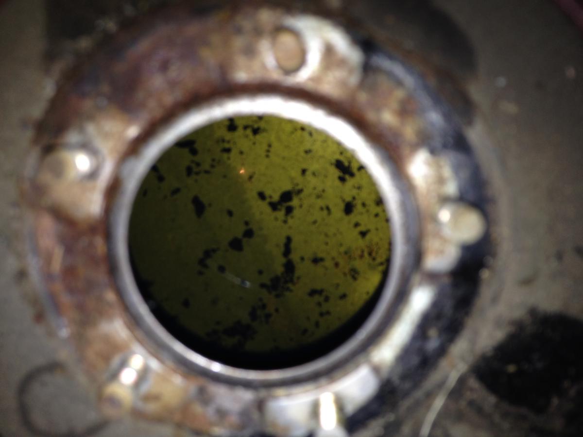

  1. Picked up a new fuel filter to keep in the car for piece of mind and made the trip last night. 400 miles later, no trouble whatsoever. I did fill up at about halfway just so I'm not picking up the dregs of the tank, but I think I probably didn't dump as much crap in there as I thought. I'll probably try to drain/flush it at some point and install a filter before the pump, but for the most part I think I'm in the clear. Thanks for the help!
  2. So I ended up bringing it into the shop and they said the tank looked really clean for an '89, so I think I'm just gonna carry an extra filter or two, keep the tank filled and hope for the best. For a fuel injected, is there anything besides the filter in the engine bay?
  3. So I took the sender out just to see how bad it is. I'm not even sure what's pictured is from what I dropped in. Pic is attached. Could I be alright just leaving it? Would draining the tank even take that stuff out with it? Could I possibly just have a shop wash it out? I'm not supposed to work on it in my garage so whatever I do needs to be in secret or at a shop.
  4. Well unfortunately I have a full tank I also haven't moved the car since I drop the junk in. Is it gonna flow right to wear the pickup line is?
