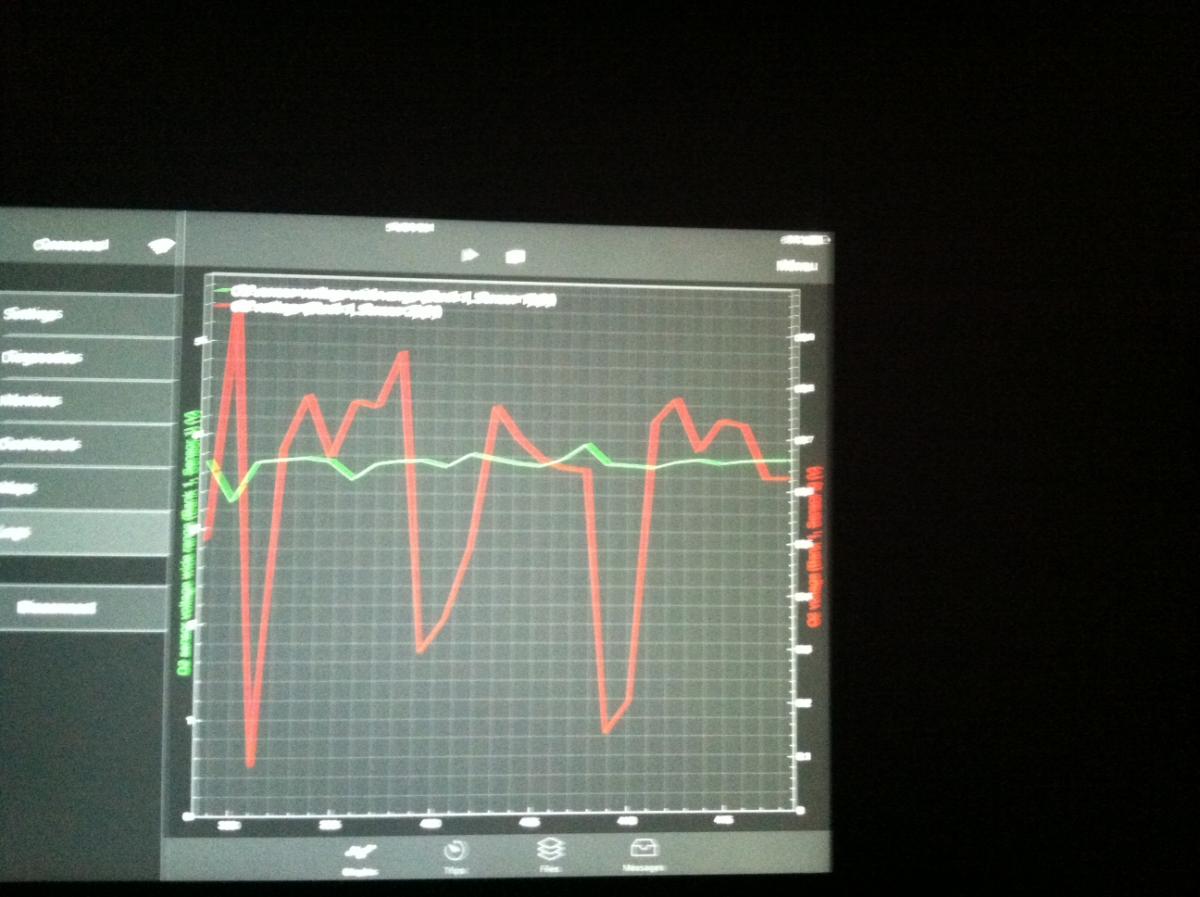

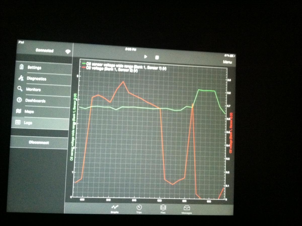

mwd replied to mwd's topic in 1990 to Present Legacy, Impreza, Outback, Forester, Baja, WRX&WrxSTI, SVXChecked for leak at exhaust flanges at idle and higher RPM (~1500 RPM). None found using hose to ear technique. New gaskets at heads recently with head gasket replacement. Car has MAP sensor: Warm idle = 6.5 inHg. 2500 RPM = 5.9 inHg. Drove car again logging Upstream O2 and post cat O2. Saw 4.7 V upstream O2 during decel. As low as 3.2 at WOT, 5th gear uphill 2500 RPM. Here are some screen shots of Upstream O2 =GREEN range 0-5 volts. Downstream O2 = RED range 0 - 0.9 volts. These O2 sensors have never been replaced as far as I know. 2000 Outback Limited 5 sp. 2.5L.
