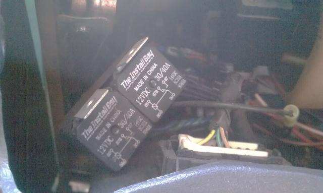

firstjump replied to firstjump's topic in 1990 to Present Legacy, Impreza, Outback, Forester, Baja, WRX&WrxSTI, SVXany guidance on removing all the remote starter stuff? Here's some photos (yeah sorryabout the quality):

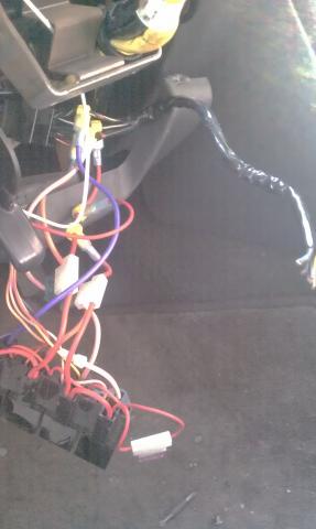

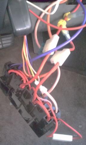

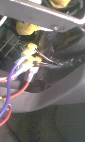

firstjump replied to firstjump's topic in 1990 to Present Legacy, Impreza, Outback, Forester, Baja, WRX&WrxSTI, SVXI'm back. Thanks for the replies. I didn't mean to sound ungrateful ... just been away for work for the last couple of weeks. .... that being said, here's where I'm at. I took your word and began doing this myself. All went well getting the steering column off (@#$% stripped screw excepting ... but that's life, right?) and locating the ignition switch. Thank you for the help on that. Yes that ignition switch is on the left/door side of the steering column and you need an angled and very small philips head screwdriver to remove it. PROBLEM: I removed the ignition switch and then came upon a problem. I followed the switch's wires over and encountered a mass of couplings. The following pictures illustrate this. this is the ignition switch, right? ... and here's where it connects: Notice it has the three yellow connectors ... as compared to the "plug" connector I expected it to be based on FairTax4Me's awesome post: http://images.apwcontent.com/is/image/Autos/201-1804_is?$APW_imgProd$ UGH! Is this something that happened with the remote start system that the previous owner had installed?? I'm sorry for being such a newb and being scared to screw something up ... it's never something too simple. What do yall recommend. thanks again for all your help. Cheers.
