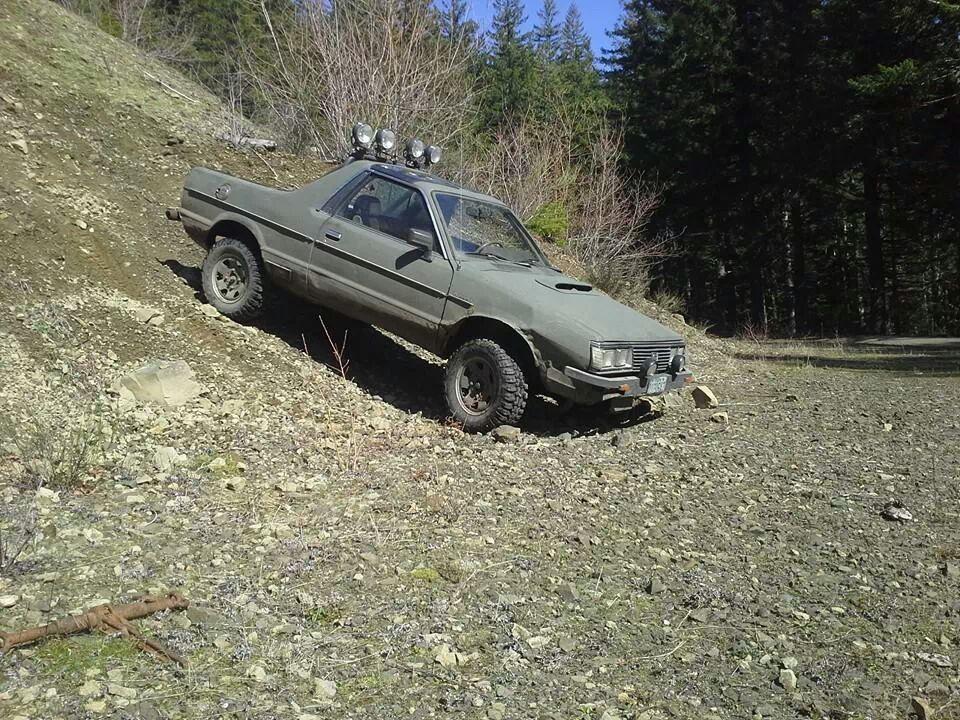

Stopped above Detroit lake for a few shots. I dont even know what to say about this thing but i sure do hope all these ol subies are this fun! If II had room id have another.

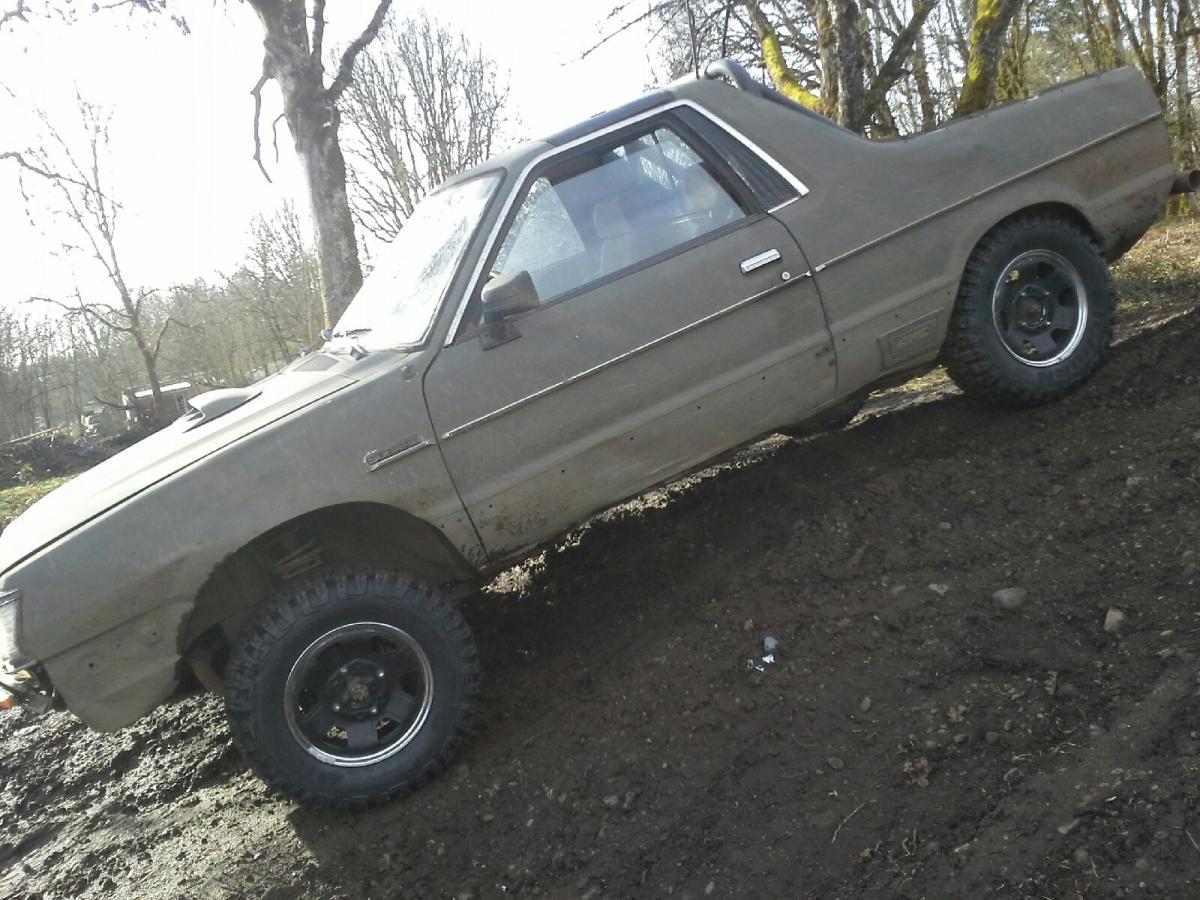

Mostly. Just put legacy cups on both ends of my rear cv axles. Haven't tried the welded rear diff yet that will be yes or no. Can say 600 miles without changing one. And I am kinda hard on them. Front came pretty easy. I made plates that sit on the lip of the engine carriage that hold the control arms inward just enough to keep from binding or over stretching. Although I do not want to get too cocky and any tips are surely welcome.

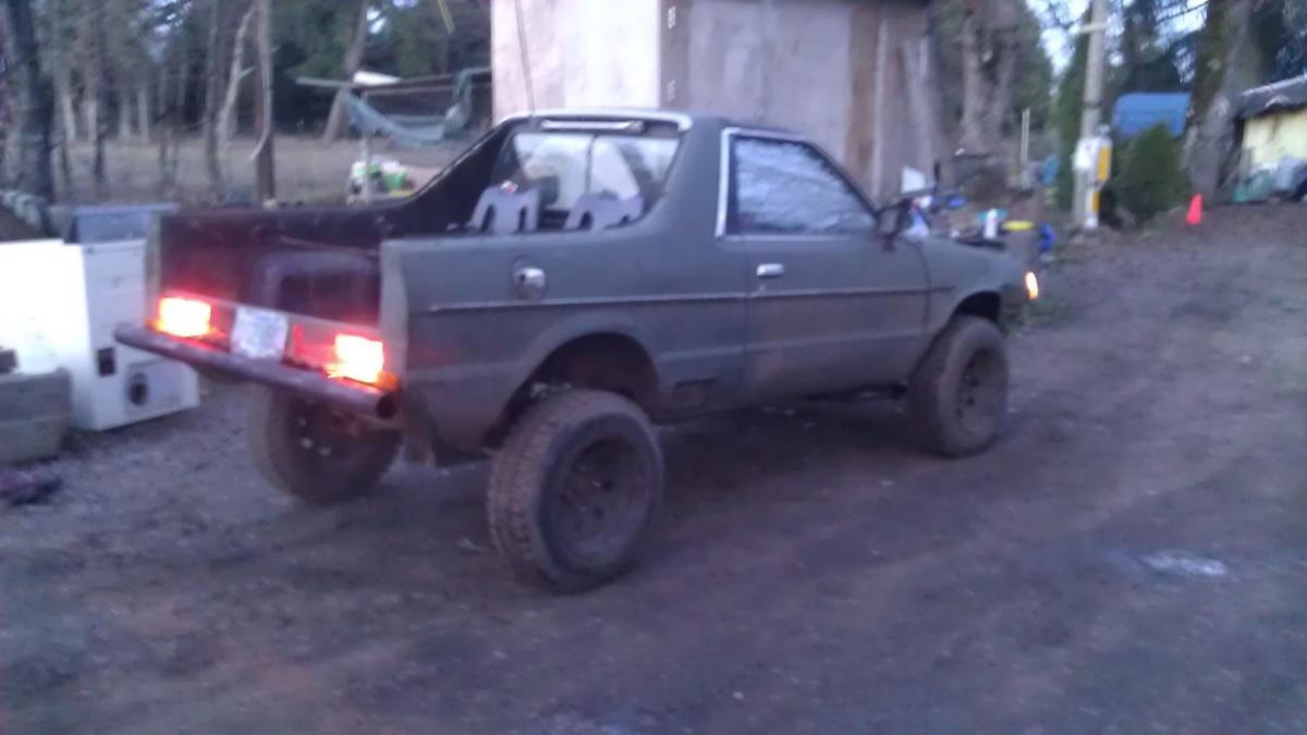

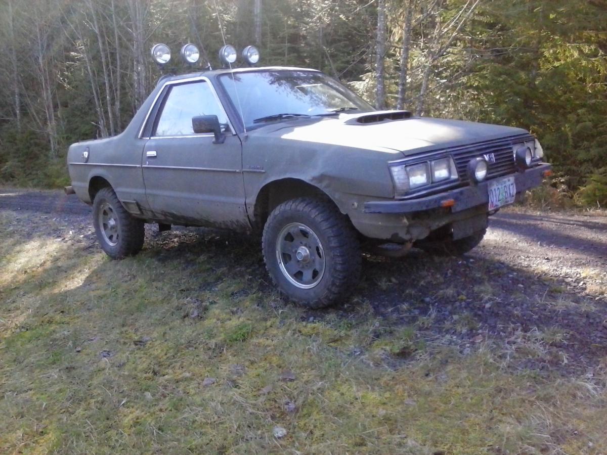

Made a temporary front bumper out of an old total gym type deal. Came out better than expected. Gotta dosome research on rear cvs and how I can get em to hold a little better atleast. Seems to blow the passenger side rear each time I get on it. Figure it should be better with air shocks to help align them. It squats in the rear because of the heavy bar and box as is any added angle blows em. Fun none the less.

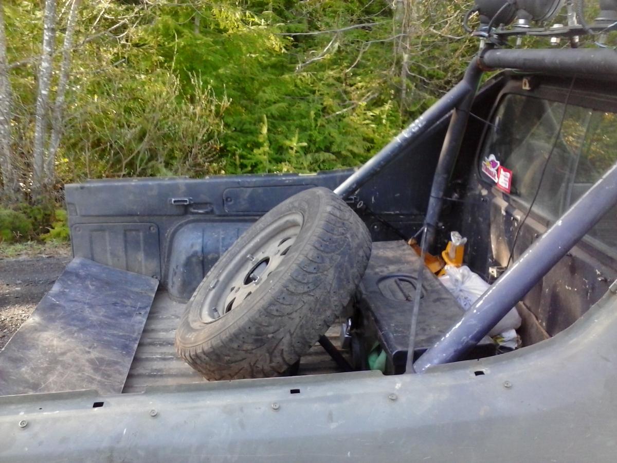

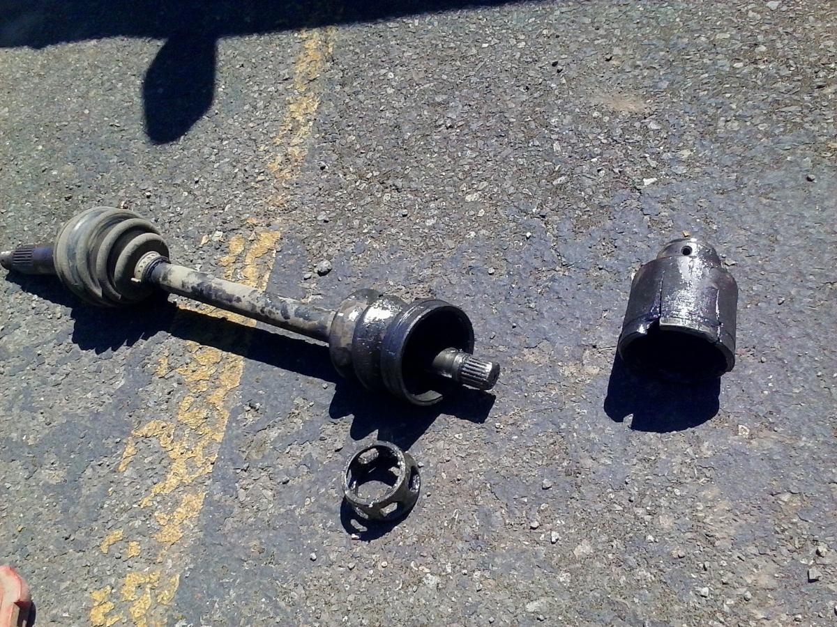

Just a shot playin in the front yard of my running grounds. And not shure if I ever posted this shot of my roll. Paid 150 to tow it to the road. Tossed on a spare dropped a cv I tore apart. And drove home as this thing has always done. Oh yea wasn't drinking just on my way to drink so kinda worse I guess. Costed me bout 250 to have it mobin again. People are quite amazed that its not worse when I tell em.

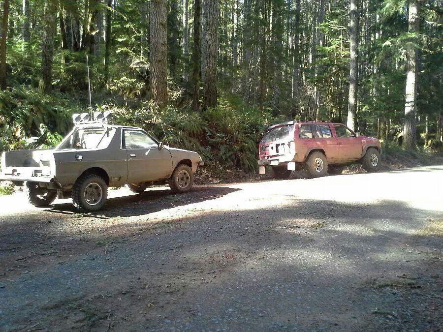

Snapped some shots when waiting on yotas to get there bald rump roast tires outta the way. Just brought pressure to 15 rear and 20 front. Was just playin. Seemes harder to make it thru the ruts guys in front made. We call this the panty dropper trail.

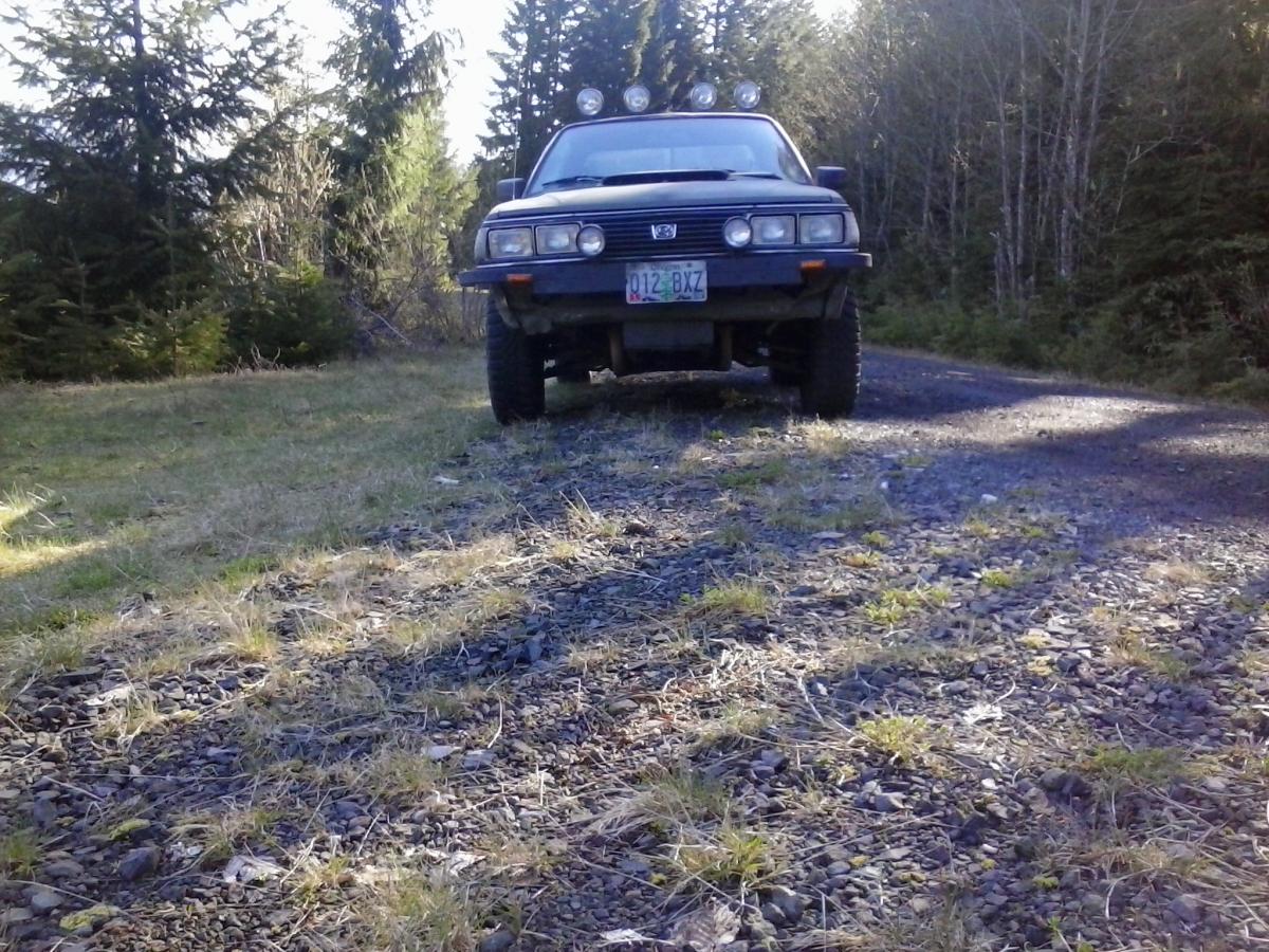

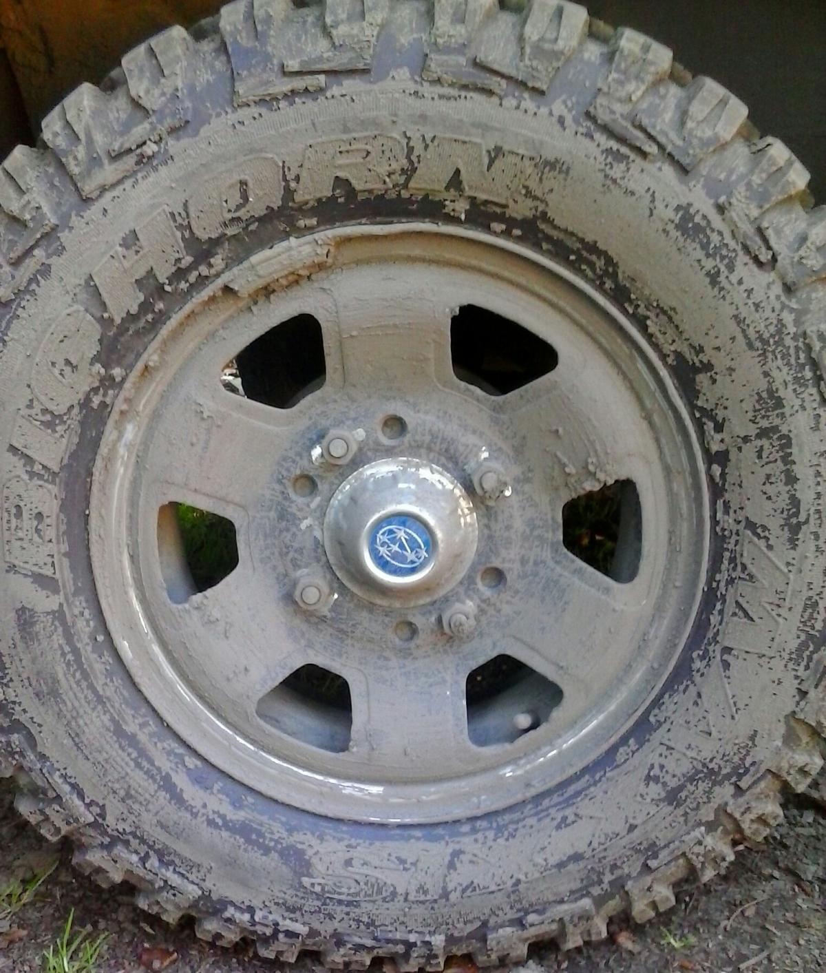

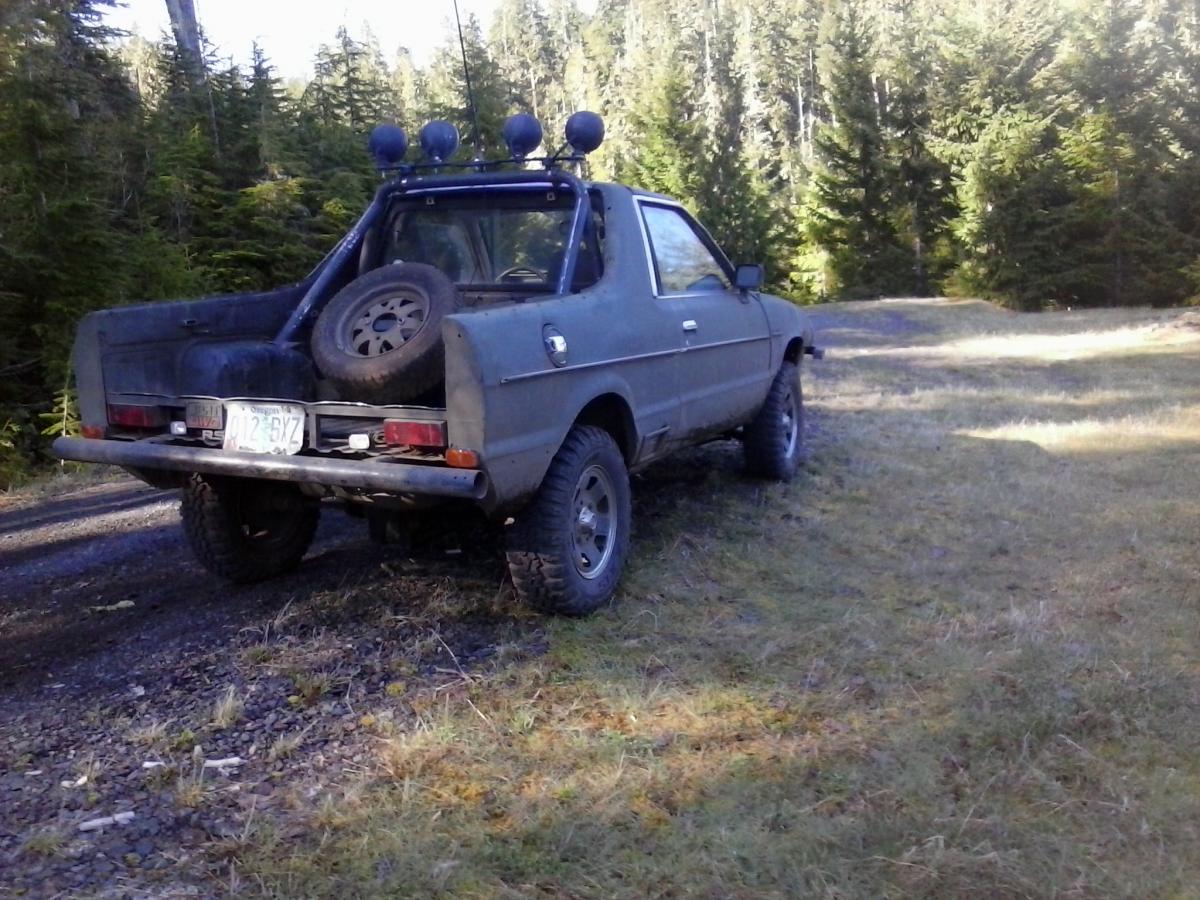

4" lift S10 rear shocks D/r 5speed Brand new 27" bighorns Slight cutting and no rubbing Drilled nissan or toyota 14" steels Roll bar I found under a bridge and narrowed to fit Half a full size chevy truck box And bobed 8ish inches Thrush and strait pipe 99 outback sport scoop Rolled only once 108,000 original miles Stock ea81 ngk/ regular healthy tune up Weled rear diff I swap in and out depending on weather Bumpers to come.

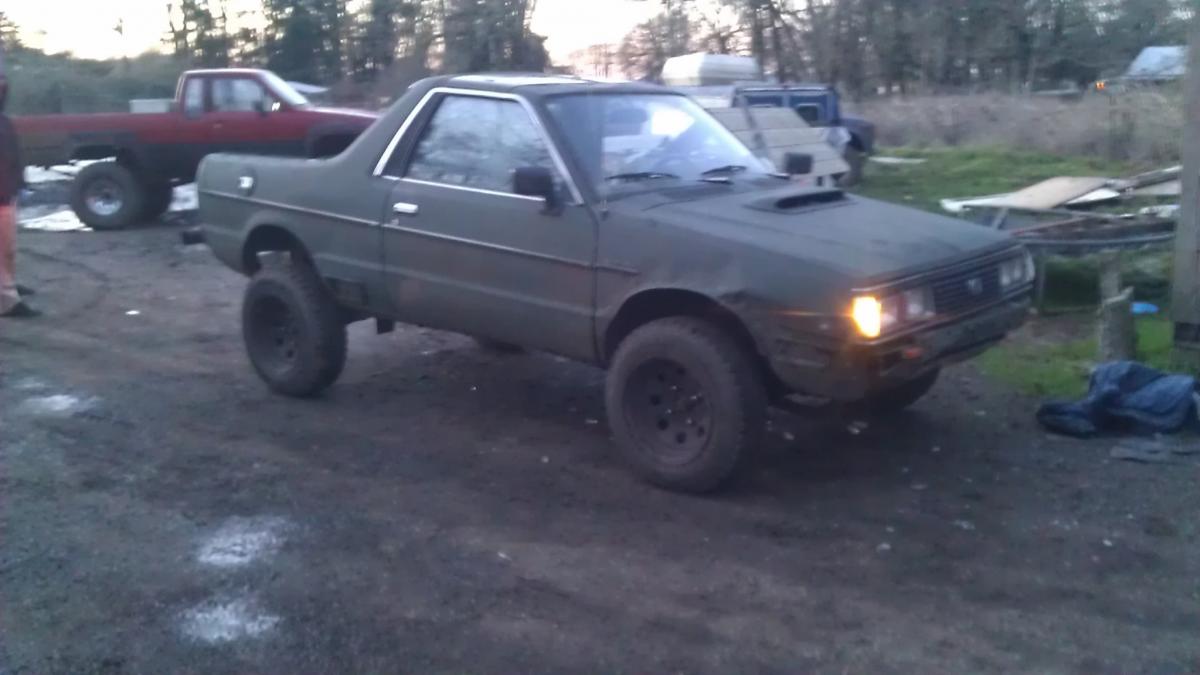

83 brat is lifting excessively when accelerating
The front wheels had way too much tow in. Found I had about a half inch difference in the front vs rear spacing between the tires. Thanks I've now learned how alignment works. I also had loose/missing motor mount bolts. I later noticed.

It kinda went smooth strait but any slight sway or turn and it sounded like my transmission was going to exploded. It was jerking hard enough to bark the 28" swampers on both sides on my slow voyage home. Not sure how to explain it but I know what broke just gotta have the ol brat goin again!

It crackeld poped and banged all the way home. Cvs r fine hubs are good. I believe it simply blew the spiders and the ring and pinion is still fine. This same thing happened when I blew the diff in my datsun but it didn't drive home. If anyone's got a dl 5speed laying around I'm lookn. Thanks all.
alright so first reply nailed 75% of my issue. a few u tube videos and some of the wonderful info i found on this site got both wheels spinning again insted of the wild walking from side to side. even tho it was quite fun to drive that way its much safer getting out in traffic in the middle of town now. i believe i still have something bent. not finding anything but a little sloppy wheel bearing but i had way worse with decant handling still. so the hunt continues! Thank a million guys i saved 75-100 bucks in 20 mins insted of having an alignment shop tell me its too bent which i already know.
hmm good info never really thought about that.ive been trying to find a broken mount. thanks ill check it out a bit more.

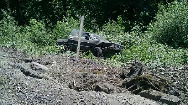

Well as the picture shows i rolled it. got some front end damage when i hit the concrete divider. drove it home. but any thing above 40 the front wheels would howl. when i looked at them the driver side was not aligned with the passenger side. bit of adjusting the steering arm fixed that. but now the front end is rising alot under acceleration to the point im spinning tires. didnt happen before i rolled it.nothing visually seems wrong from what i can tell. any pointers or advice would be much appreciated. stock healthy ea81 d/l 5speed 83 gl brat. thanks for reading.
