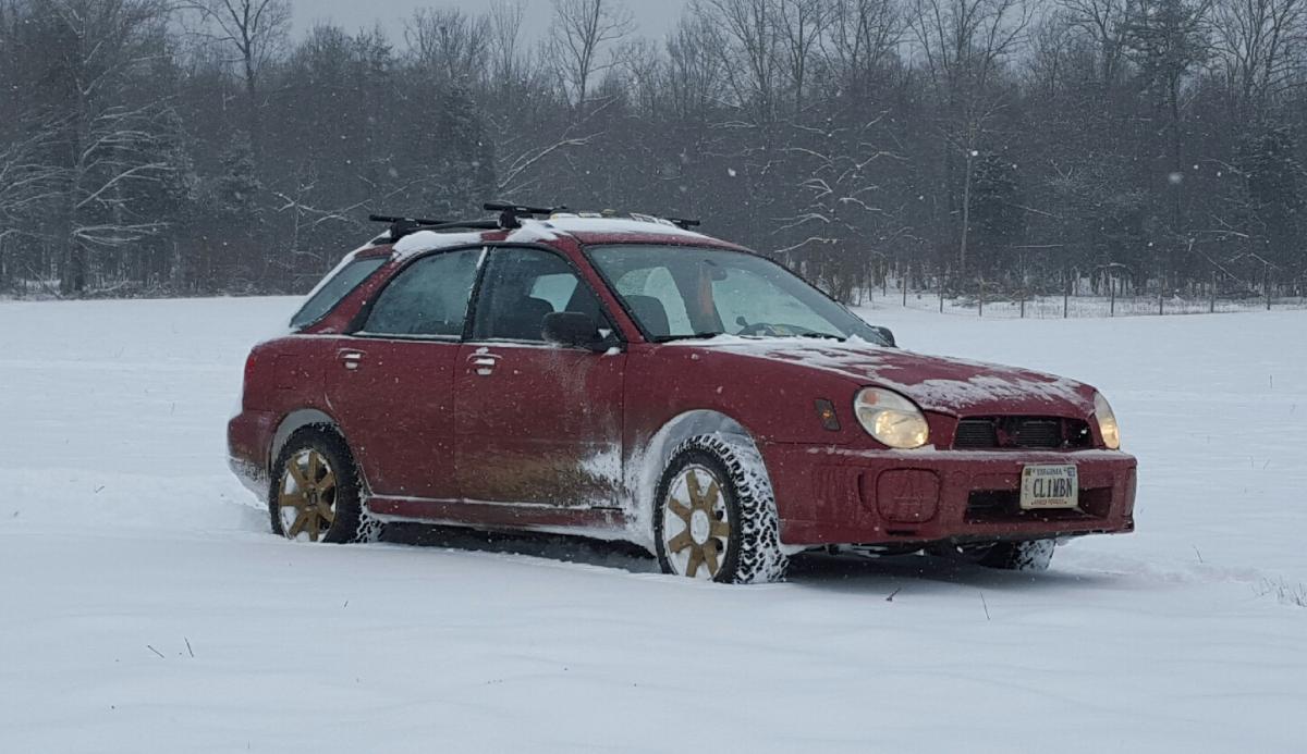

  1. How do you attach pictures so they're not the tiny thumbnail? Is it because I'm doing this on my phone. I'm getting whooped and I'm usually pretty text savvy. Attached is a better view of my stance
  2. Kept the sway bars.. it's a daily driver on the interstate.
  3. Running 215/65R16 General Grabber AT2. They are amazing. Very minor rubbing on front liners when turning hard while hitting bumps. I would recommend wheel spacers though because I barely have a finger width in between my tires and my springs. Hasn't caused any problems but better to be safe than sorry and it would give the stance a little more width and would look awesome.
  4. My impreza with Forrester swap.
  5. On an 02-03 impreza you should only need Forrester struts and rear trailing arms. Everything else bolts right up. I lifted mine like that and it turned out great.
