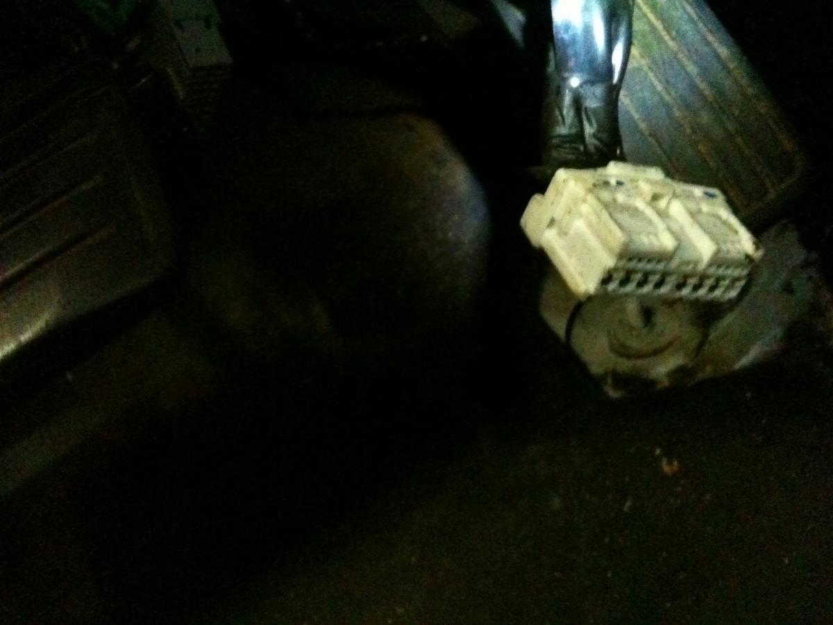

Not too worried about a cel for that as my understanding is it should run fine without those... I haven't been able to get a cel at all since the swap... I'm pretty sure these have something to do with it. Not sure what they are/do...(not the check connectors) -

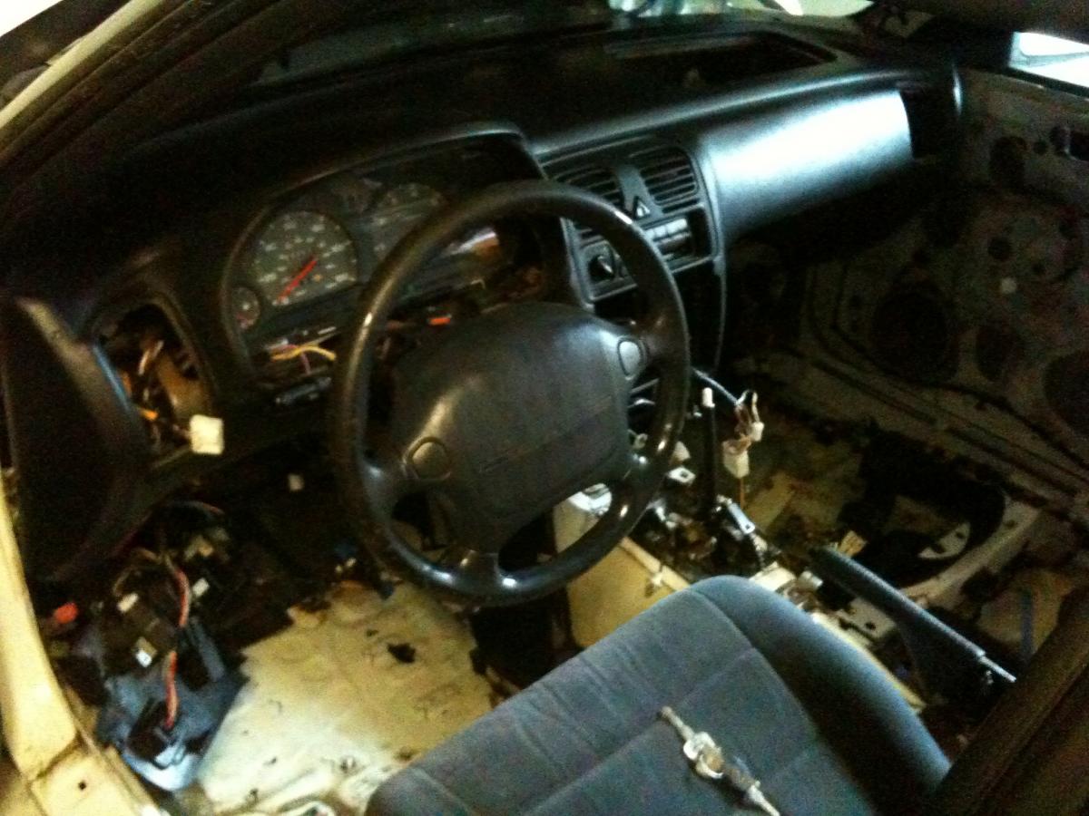

Hey guys I have 2 issues.. After a swap I'm missing a control unit under the dash( not sure what it is/does... And I don't have the fuel pump working ...(might b related) please help... Btw I took a 94 legacy sedan lsi chassis and put a 99OBW drivetrain(motor/trams/diff axles sturs hubs tires etc. aswell as the entire body harness fuel pump and dash.. Big frenchin project by yourself!( I did not use the OB gas tank, evap box, or drvr side sending unit. I'll post some pics when I figure out how! Lol!

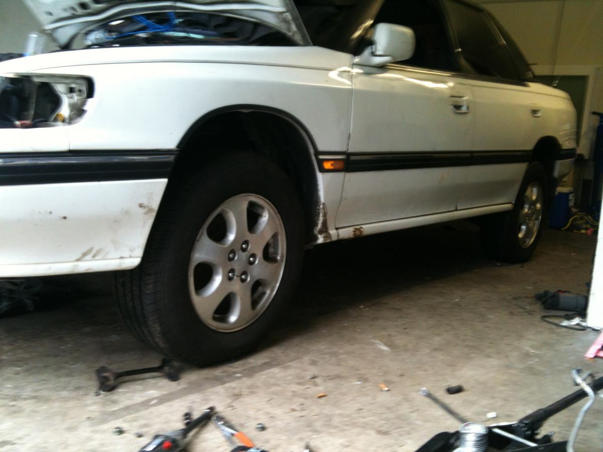

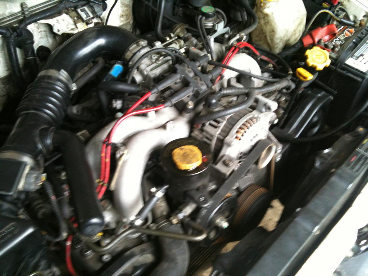

Hello all. Been looking on the site for years but now I have a question so I signed up lol. First, I had a 1994 legacy lsi 4wd 2.2 at...and swapped in a (donor)99 ouback drivetrain 2.5d/at ( motor tranny diff axles hubs struts tires etc and yes it's lifted) I also did the dash swap with the whole ob harness(body dash gas tank engine bay).... It's sitting on the ground now and all I have left to do is the wire the pwr lock/ windows and figure out the fuel...which is my issue... Harness is all plugged in... I used the ob fuel pump in the 94 legacy tank) so, I have no cel, no fuel going to the motor and I'm not sure why. Also noteworthy, I did not use the evap box behind the pass side rear wheel( was smashed in the wreck. Please help... I'm stumped on the 2 month endeavor
