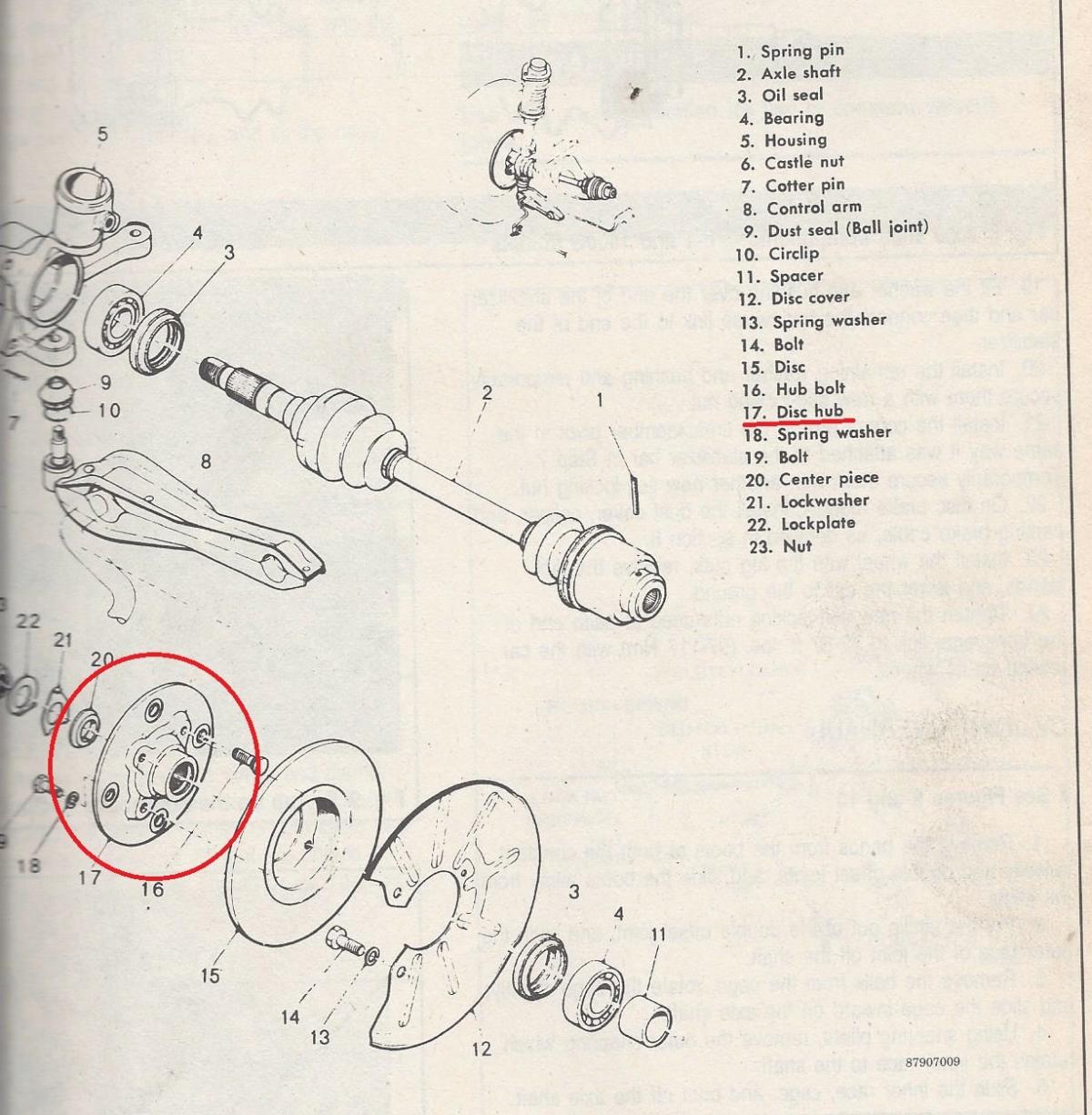

Yeah I understand, I wish I could be able to make a trip up north and go through some junk yards to look for myself. I've have been thinking I could swap the one from the driver side to the passenger side, as a temporary solution. Considering since that side is the one that spins at the moment. This probably a stupid question, but is there a way that maybe a machine/metal shop could fix my stripped disk hub?
Finally was able to scan a picture of the disk hubs i was talking about from a manual. If any of y'all have 2 spare ones, that you would be willing to sell and ship, I'd appreciate it!

Thanks for the replies! yeah its been a while, i have been lurking around to make sure the questions haven't been answered before. ill try to see if i can get the driver side to spin. Also yes i mean the the splined hub, where the shaft slides into, speaking of which ill have to get a new shaft as well, but i can those from rock auto. But its good to know i can get those rotors new as well. For the neutral problem, when i start the brat up, the passenger side shaft spins constantly, which i assume that its in gear, ill shift into second,third and forth and it seems to stay in gear. however when i try to but it in neutral the shaft still spins, and will continue until i put the clutch in. Is this cause by the linkage being loose? or a transmission problem? Also when i put it in 4-wheel drive the back wheels will turn, and stop when i put it in neutral, but the front passenger still spins. I am starting to realize that there isn't any junk yards with subaru's down here.
Hey guys, so i recently bought a 79 brat from a friend and got it running. By doing so, of course, i ran into some problems. Mainly i realized that that the front disk hubs that connect to the front half shafts are completely shaved down, So ill need to find some of those hubs. Also i tried going through the gears and when its in gear the stick wobbles around a lot, and also i can't get it to stay in neutral. Oh and the driver side half shaft doesn't turn. So my questions are, can i find new disk hubs? and can i rebuild the tranny? or is it better to get a used one? Also finding a tranny seems difficult as well, i found a website that says they have one, but it'll cost around 500. any advice is much appreciated.
