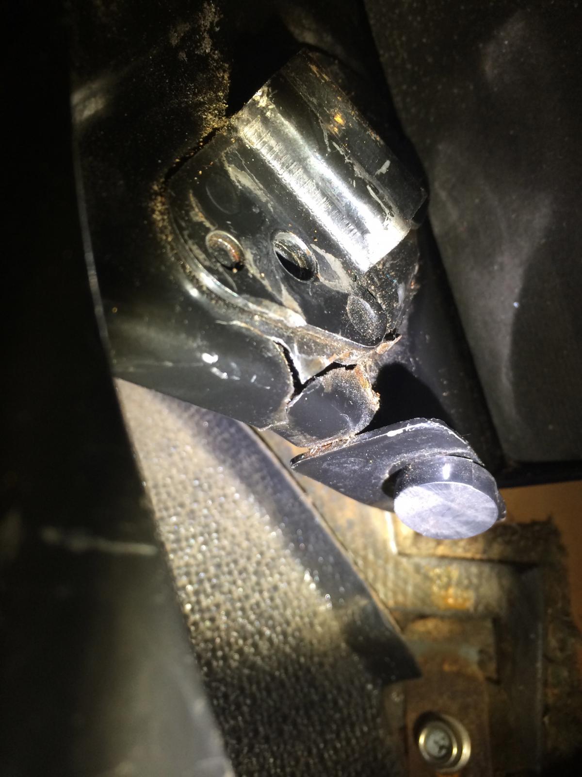

You mean exactly like in the picture below?! Not only is that cracked, which is allowing the mount to move a bit, but the stopper that held the cable to that mount sheared off the cable. Since the cable itself was still in tact and attached to the pedal, it looked like it was still working under the hood when I took my first look, but I'm sure this is the issue. New cable is being shipped, any ideas for the pedal box? I would have done this but I was in bumper to bumper traffic, so once I got it moving there was nowhere to go, pretty frustrating to say the least.
I have a '74 DL1400, and the clutch was replaced within the last year. While driving it today in stop and go traffic I had a couple rough 1->2 shifts as well as trouble getting it into 1st. All of a sudden, I felt a pop and the clutch pedal went all the way to the floor, the clutch pedal felt like it wasn't engaging at all (light and free feeling), and I could not get it into any gear. This unfortunately happened in rush hour traffic on a busy freeway, leaving me no choice but to get a tow home. Once home I checked out the clutch cable and it's in tact and operating fine. What gives? Clutch fork? Any advice for troubleshooting would be appreciated, as this is my daily for now so I am currently out of a car. What can I do to troubleshoot this without dropping the motor? Thanks!!
