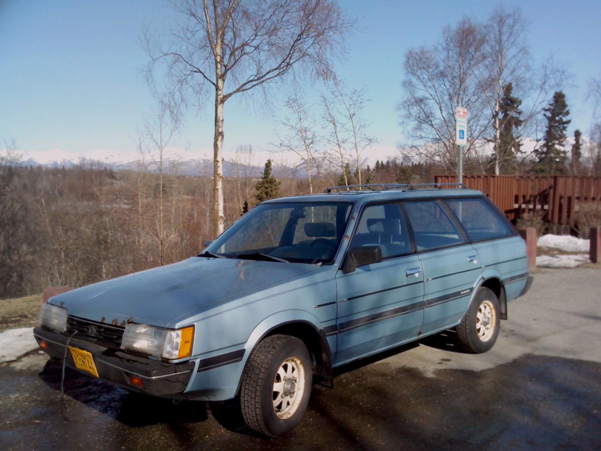

  4. 85 Subaru GL. 77k original miles. An Alaskan beauty.
