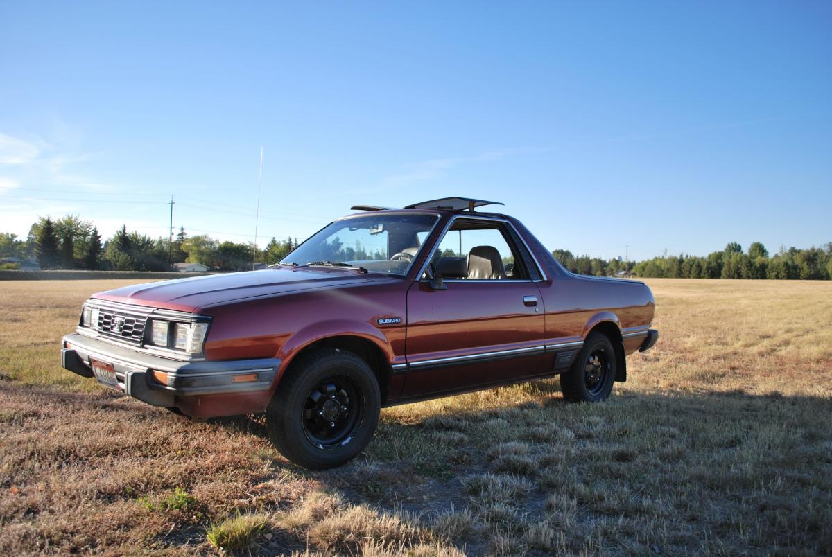

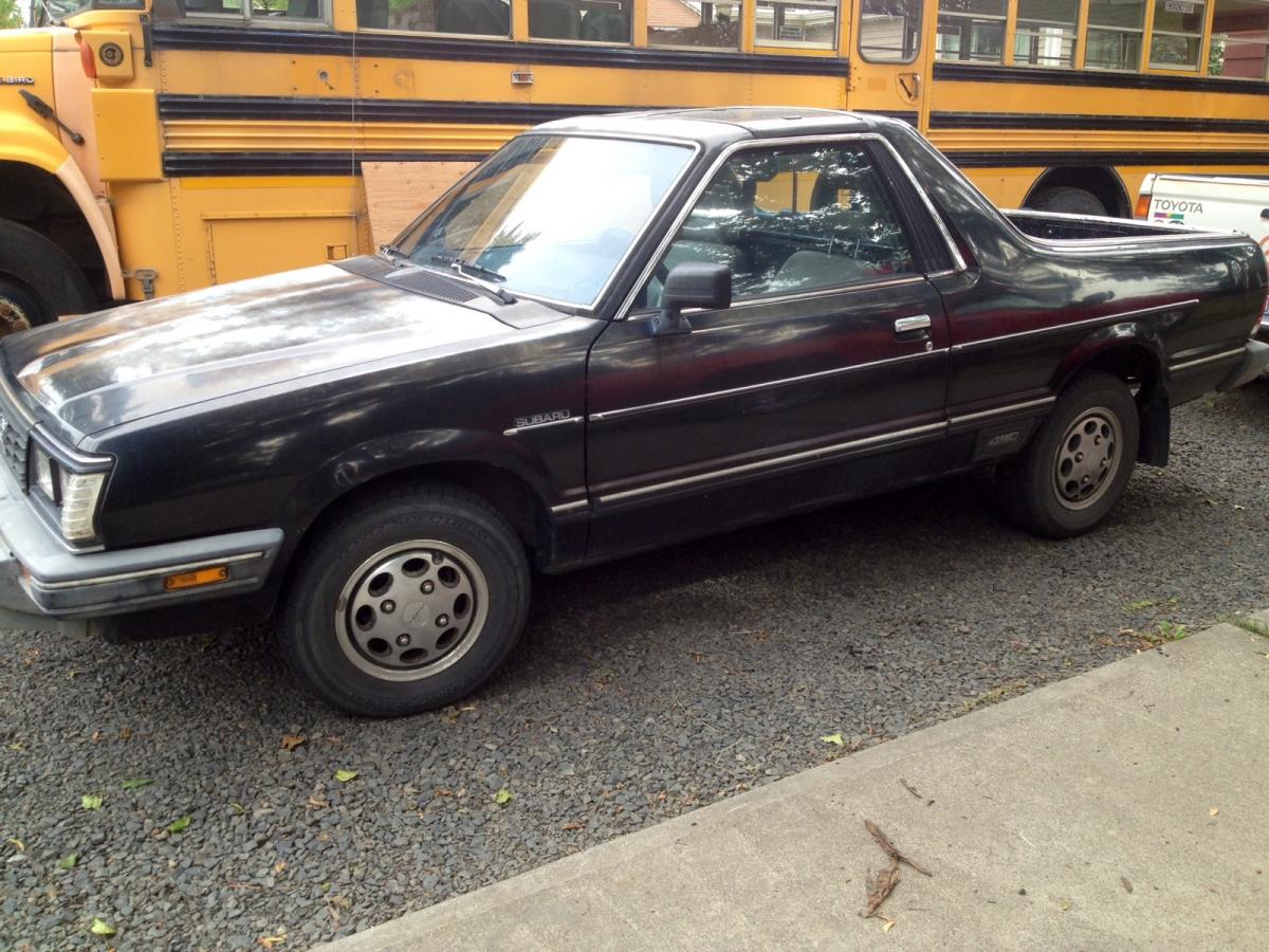

Hey everyone lurked on the forum for a while now figured id just throw up a post. This forum is so informative and has helped me with my brats on more than one occasion. Here is a pic of my first brat that i actually ended up selling to superbrat little over a year ago. The second is my current project that i just got done swapping to a weber. Planning on four inch lift, wheels, tires and paint maybe weld up some tube bumpers and canopy rack. Anyways thanks for looking.
