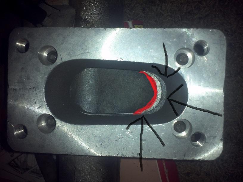

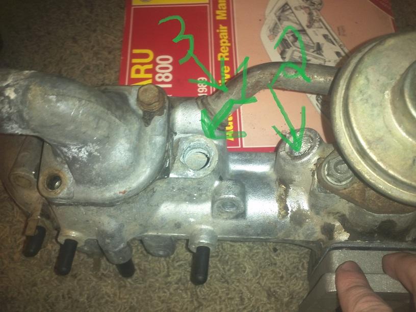

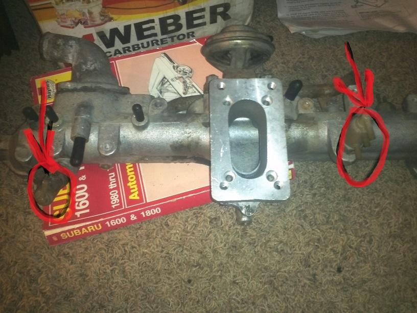

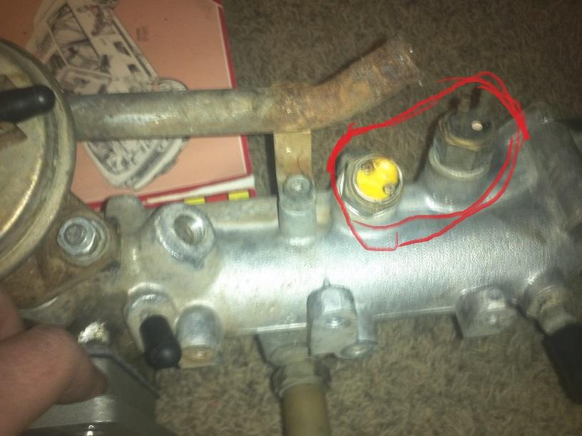

  4. hello again all, I know I keep asking question son the weber swap but, I'm confused about a few new things now that I have the kit. First off, the adapter plate seems to be off center. As you can see in the below picture, the actual intake port is where the red is. The adapter port opens where the black arrows are. so between the arrows and the red, the is the lip of the intake manifold sticking out. Is that normal or did I get a bad adapter? Can I remove the parts circled in red in the 2 pictures below? And the last picture, can I plug holes 1 and 2? and is the tube the 3rd arrow pointing at for the heater core or should I plug that too?
